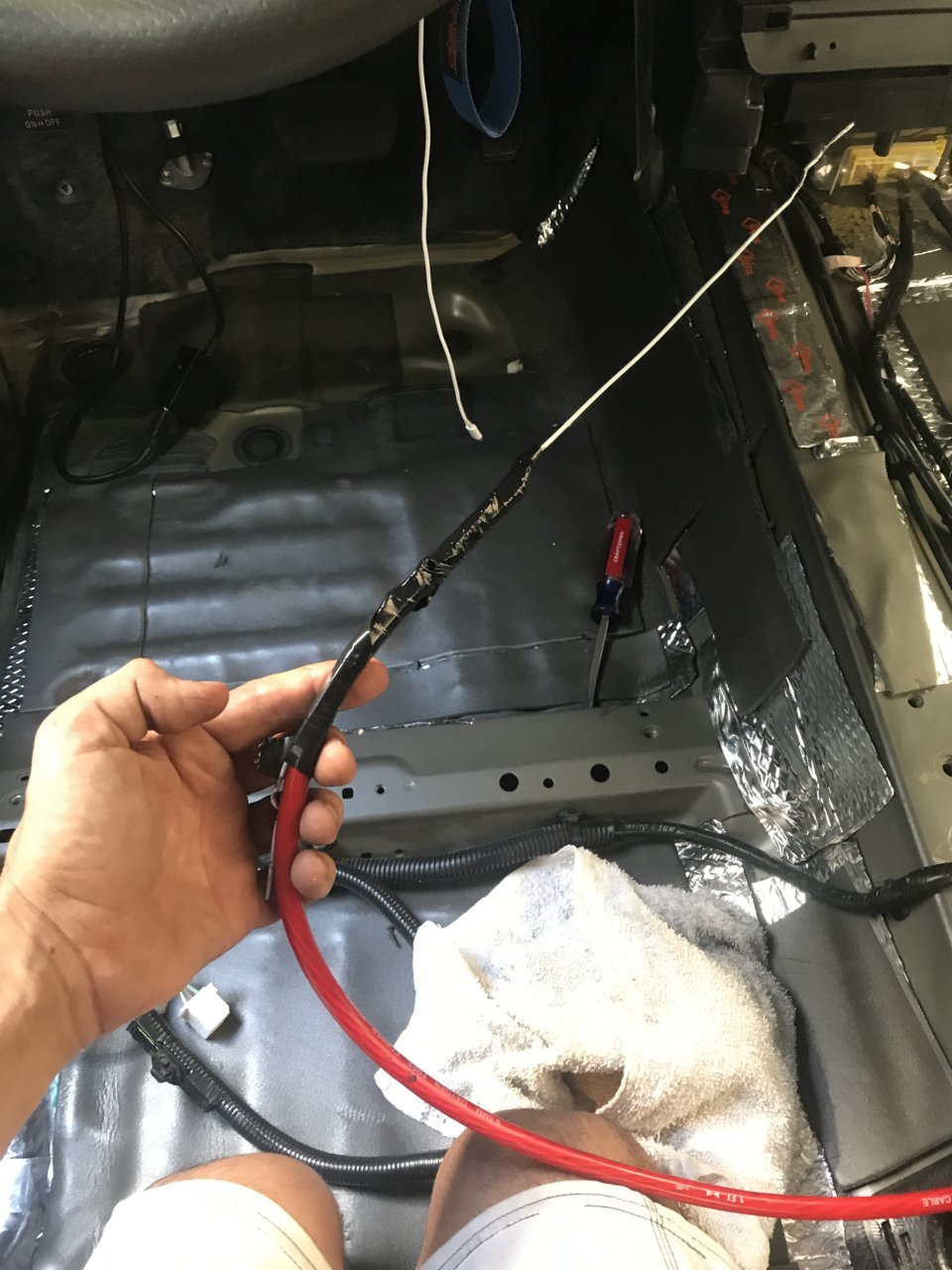

This is how I ran the power wire through the firewall. That's a coat hanger taped to the end of the wire. I pushed it through and grabbed it on the other end with pliers so I could pull it easily. Use plenty of lube
