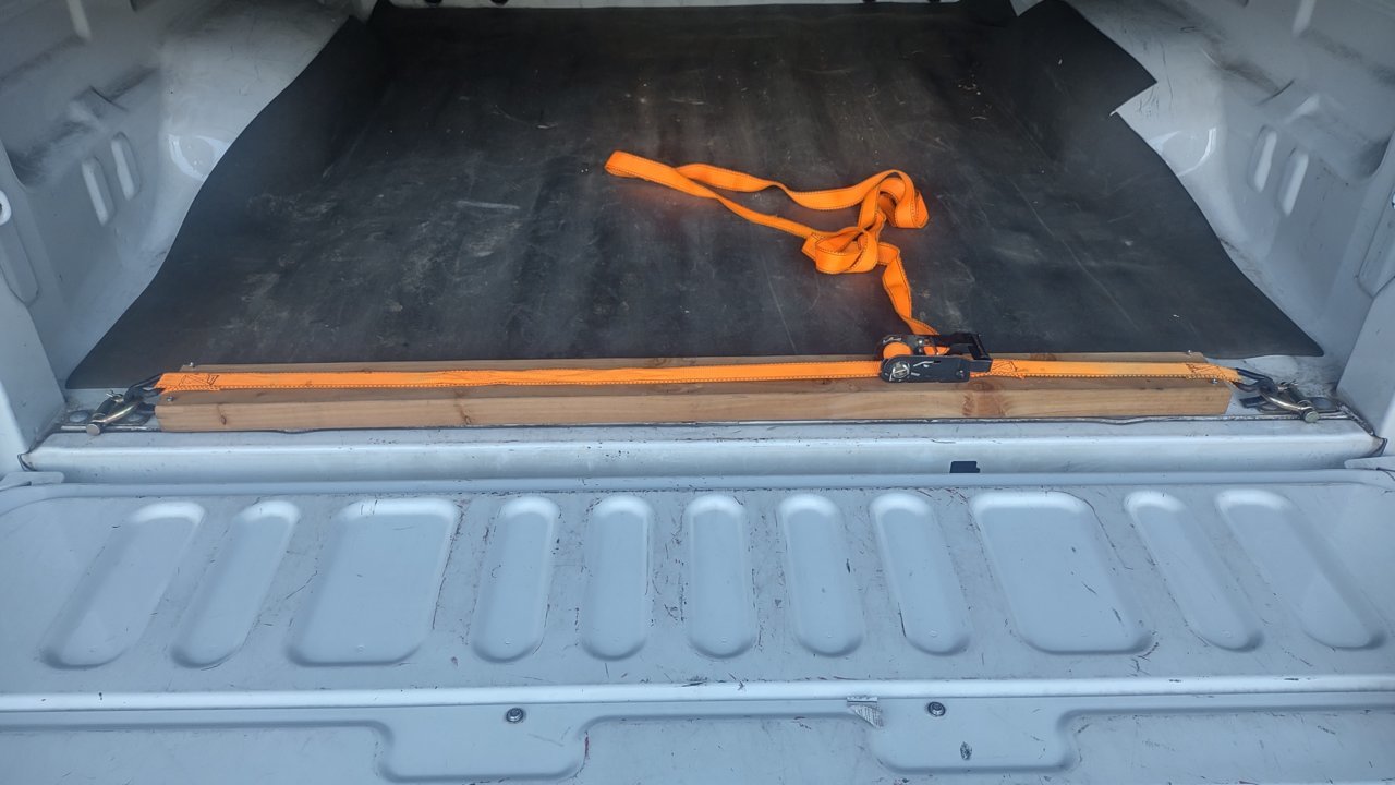

      I added two D-ring tie downs to the outside at the back of the truck (2011 Tundra). This is very useful for holding down plywood and lumber. Much easier than trying to tie it down to the bumper. I also use this 4' 2x4 to help pull down on the wood. As you can see there is a small pocked down below that you can use to put the nuts on below. It is just going thru the sheet metal of the bed but it is plenty thick and strong to hold down the wood without any problems.
