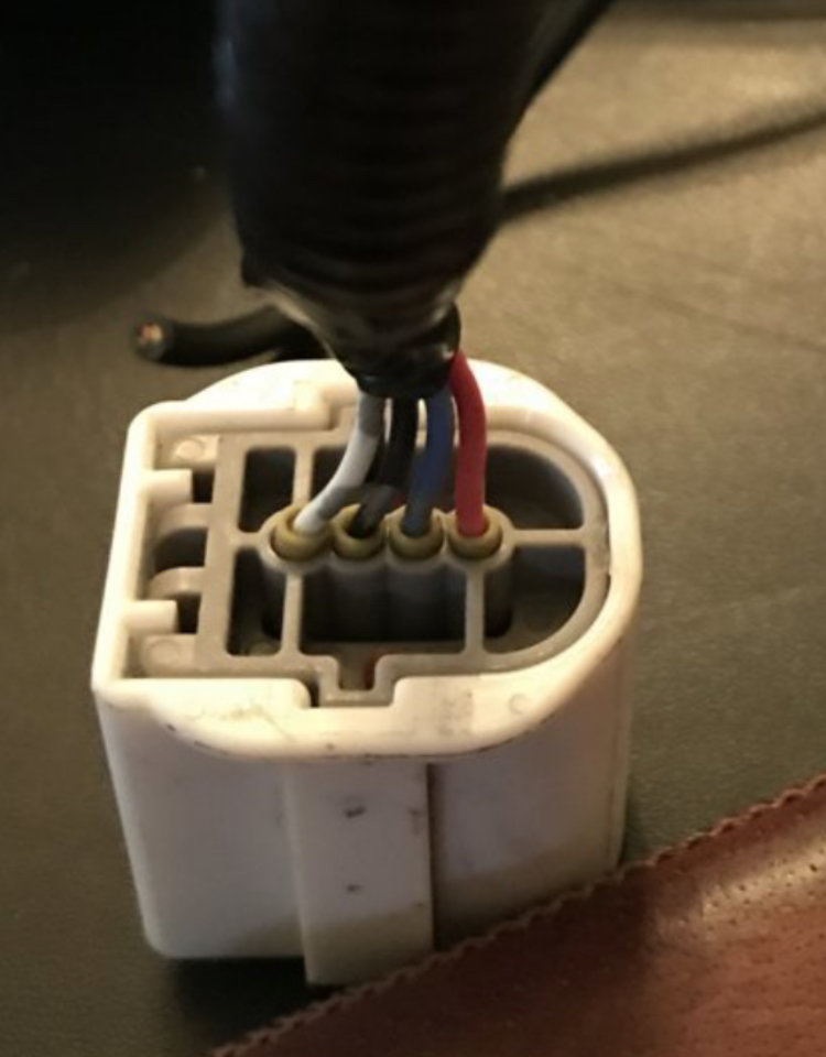

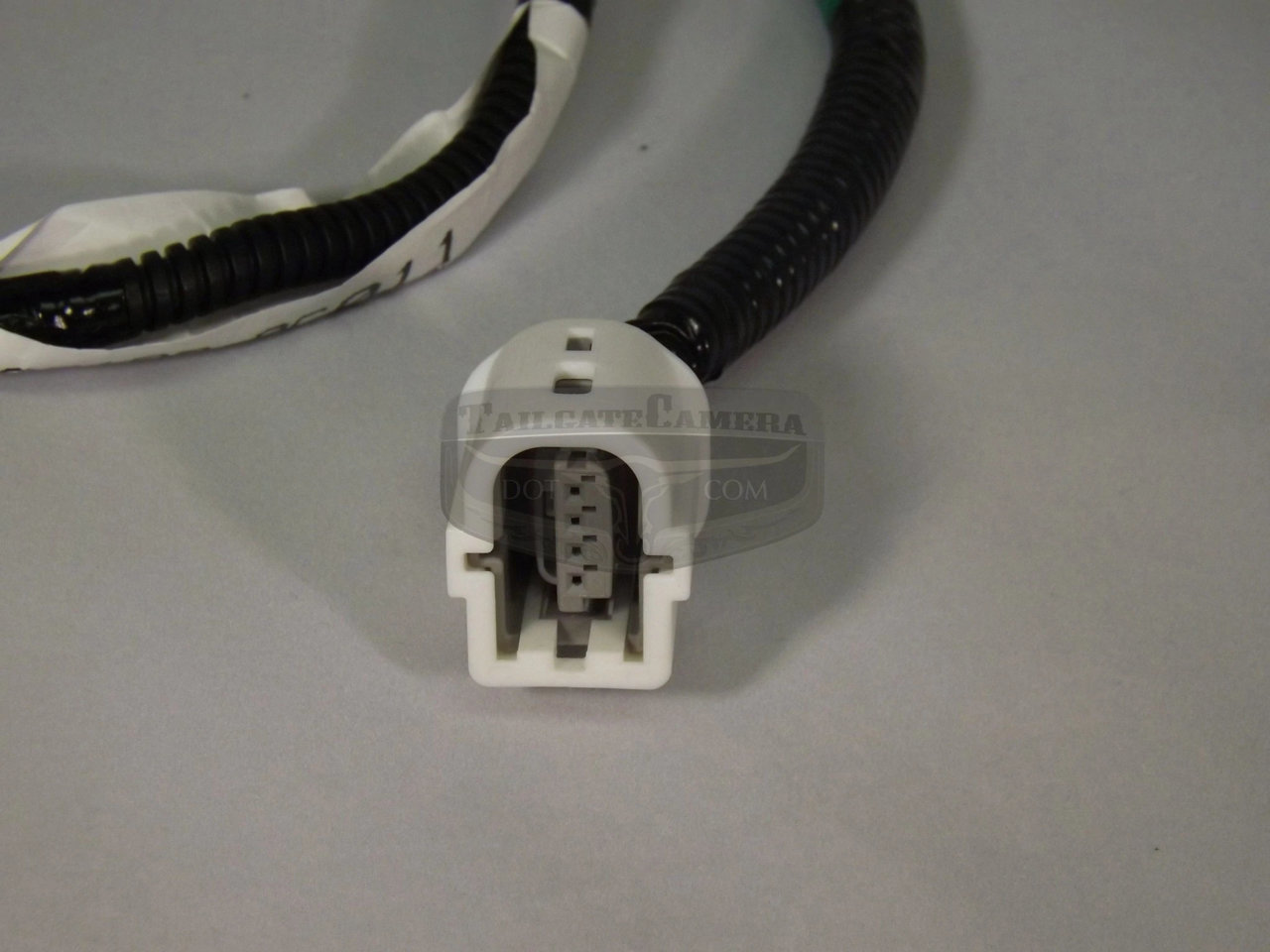

    Welcome aboard sir! If it hasn’t been previously mentioned, we like pics. Is this one of the Android units? Or an actual Tesla screen?
    Plug for camera may look like this in your year model

    Thank you, KNABORES! I have not seen one of these plugs in my dash. So is it safe to assume it has been snipped/removed?

    Rear view of connector with wire color exposed.

    1) Red
    2) Blue or Green
    3) Black
    4) white
    I will look and see which I have.
