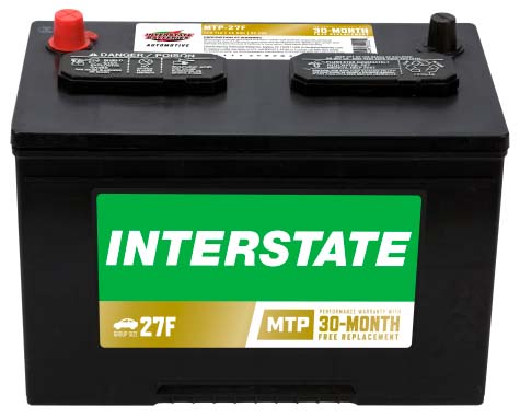

    The 'F' designates the post-placement, positive and negative.
    Tundras are set up for 'F' batteries.
    Positive/hot on the left, negative/ground on the right looking from the front of the vehicle.
    Looking at this, the 27F has less CCAs than the top 24F.
    I don't think the 27F did damage to your truck, unless the battery was bad.
    https://www.interstatebatteries.com/product-search-results/2005-toyota-tundra-v847l
    27F is a standard Tundra battery size.
    They went from 27F to 24F, Interstate AGM is 34R.
    What size is the original battery?
    If you have a 2005 Tundra, with the original battery, it is time to buy another one.
    I wouldn't care how it tested at a parts store.
    This is a pic of a 2005.
    I don't remember on my 2005, but my 2014 the OEM positive cable is so short it would be physically impossible to hook an F battery up the wrong way.
