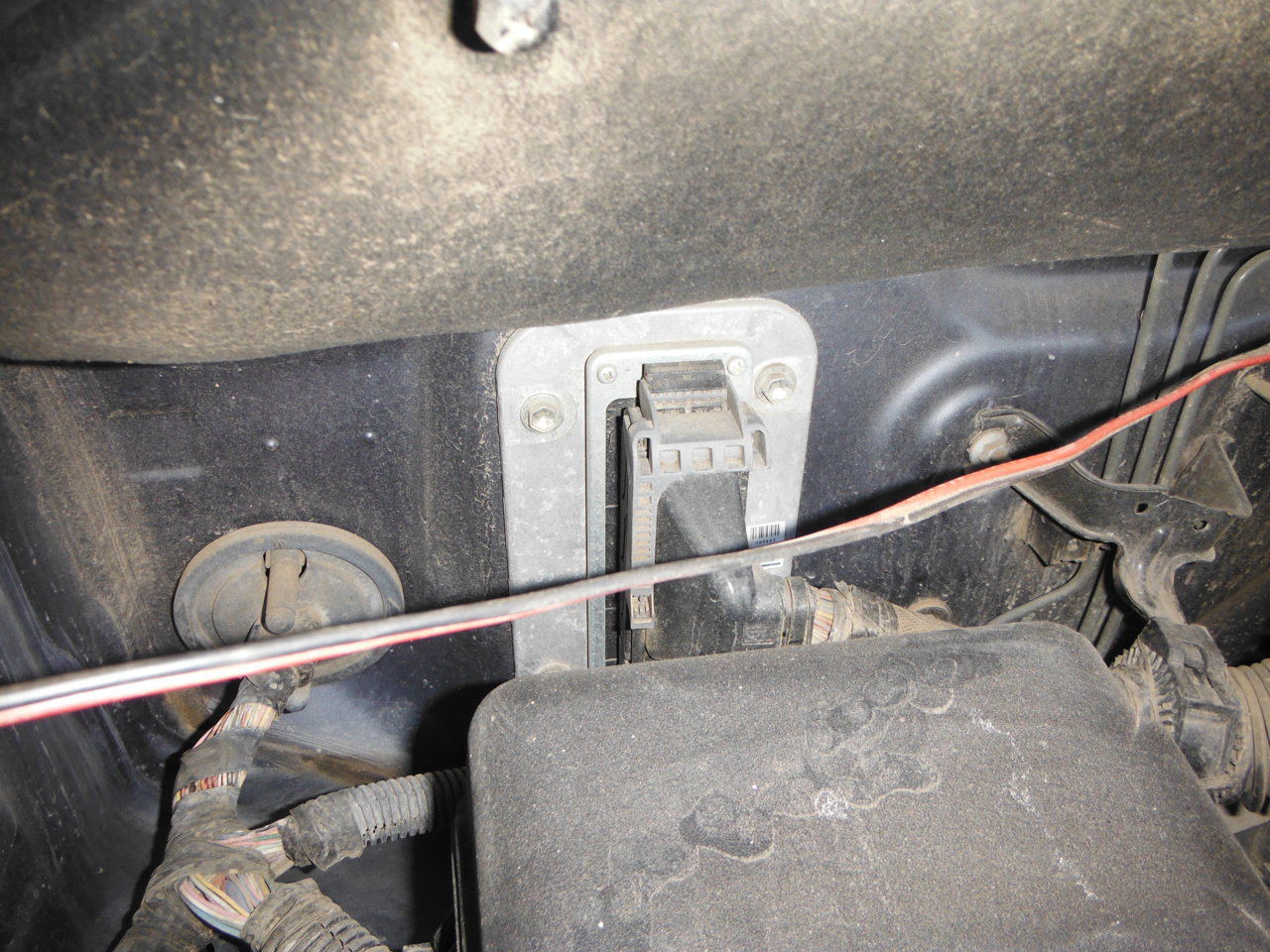

    If you're really motivated you could drill a hole and use a bulkhead fitting. I just used a rubber grommet that surrounded a factory harness. I can take a closer picture of the exact spot tomorrow but it's a fairly large grommet just outboard of the brake booster and behind the ABS pump.
    Here is the same grommet but on the passenger side:
    From the cab it is at a level just above the foot pedals.
    lbcdan[OP] likes this.
