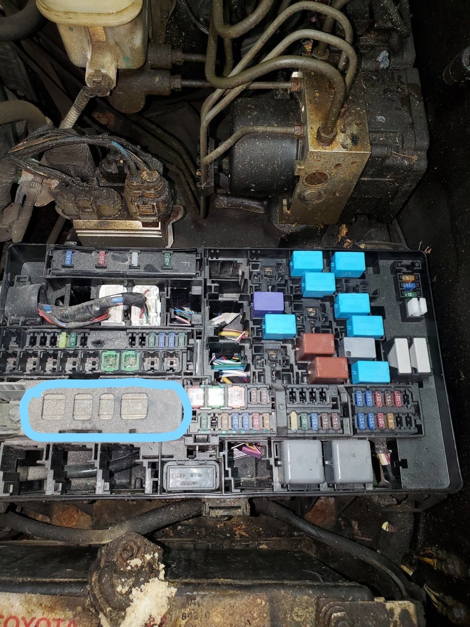

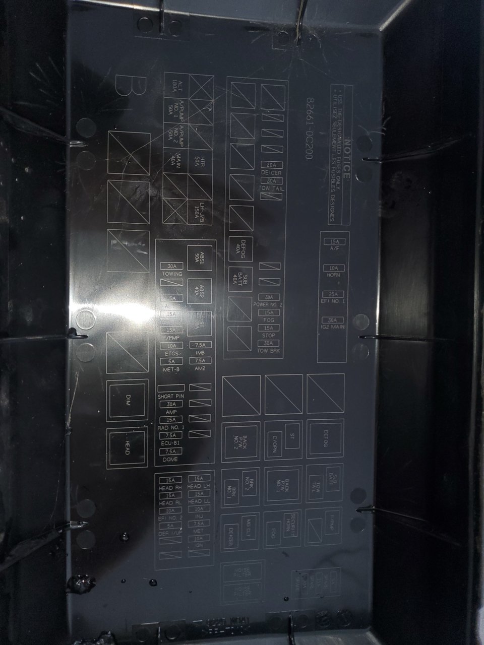

    Here is fuse box. Appreciate the help rob. Hopefully just the relay.

    I think mine may be different.

    I guess I am somewhat confused. Number 43 for the wiper should be there?
    https://fuse-box.info/toyota/toyota-tundra-xk50-2007-2013-fuses
    It's like there's some sort of cover I am not quite sure. But I believe that is just a fuse so that wouldn't be the issue I don't think.
    I am going to be forced to drive the truck. Should I pull the fuse or just let the wipers run constantly?
