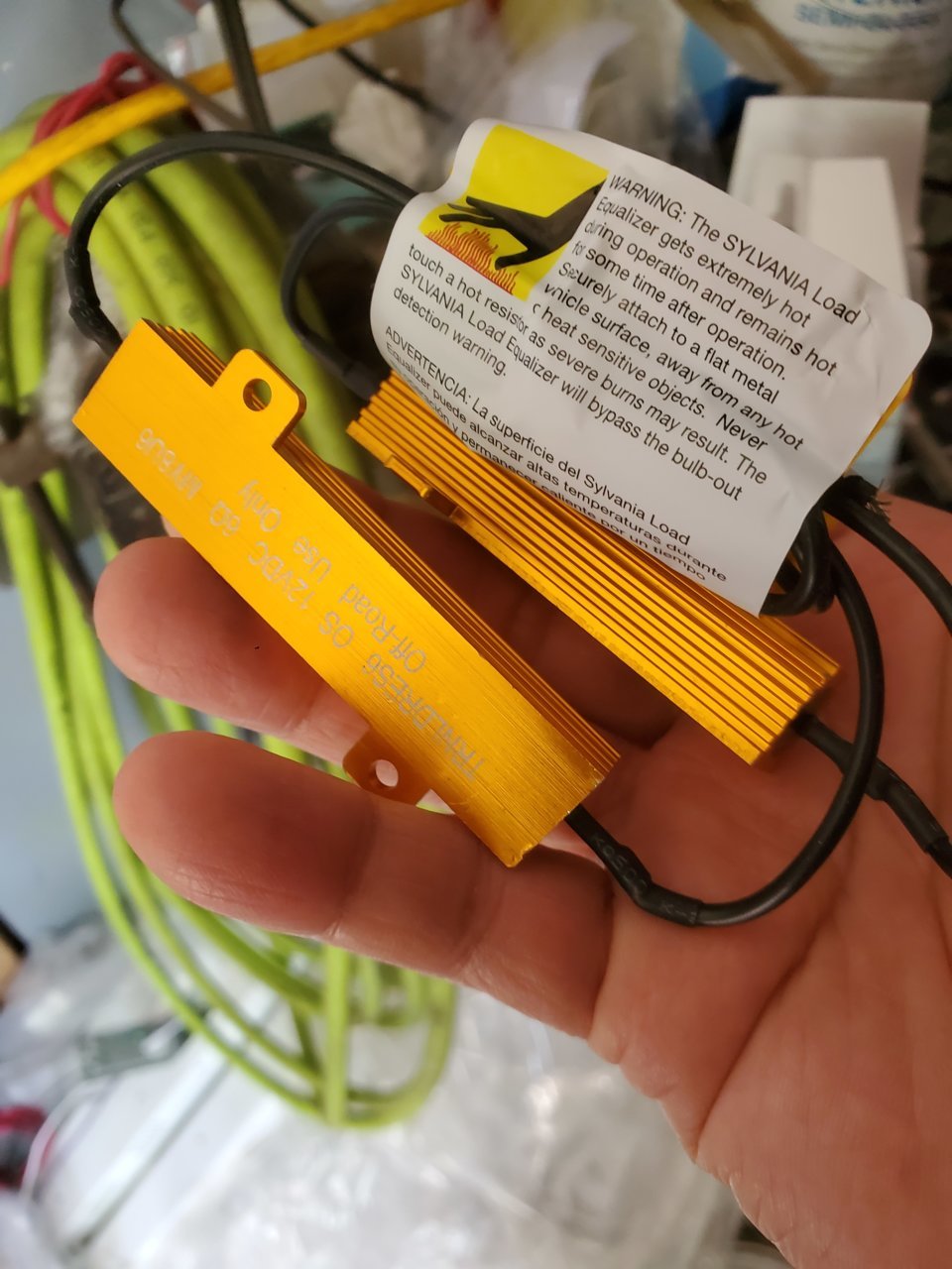

    Yes, I'm not sure the size, but you need to add resistors to the wiring
  3. Mar 27, 2020 at 9:28 AM
    Jim LE 1301 Camaro Lover, SSEM # 11
    24,067
    Welcome from NY.
    Adding resisters will end the hyper flash.

  7. Mar 27, 2020 at 9:45 AM
    24,067
  8. Mar 27, 2020 at 9:46 AM
    24,067

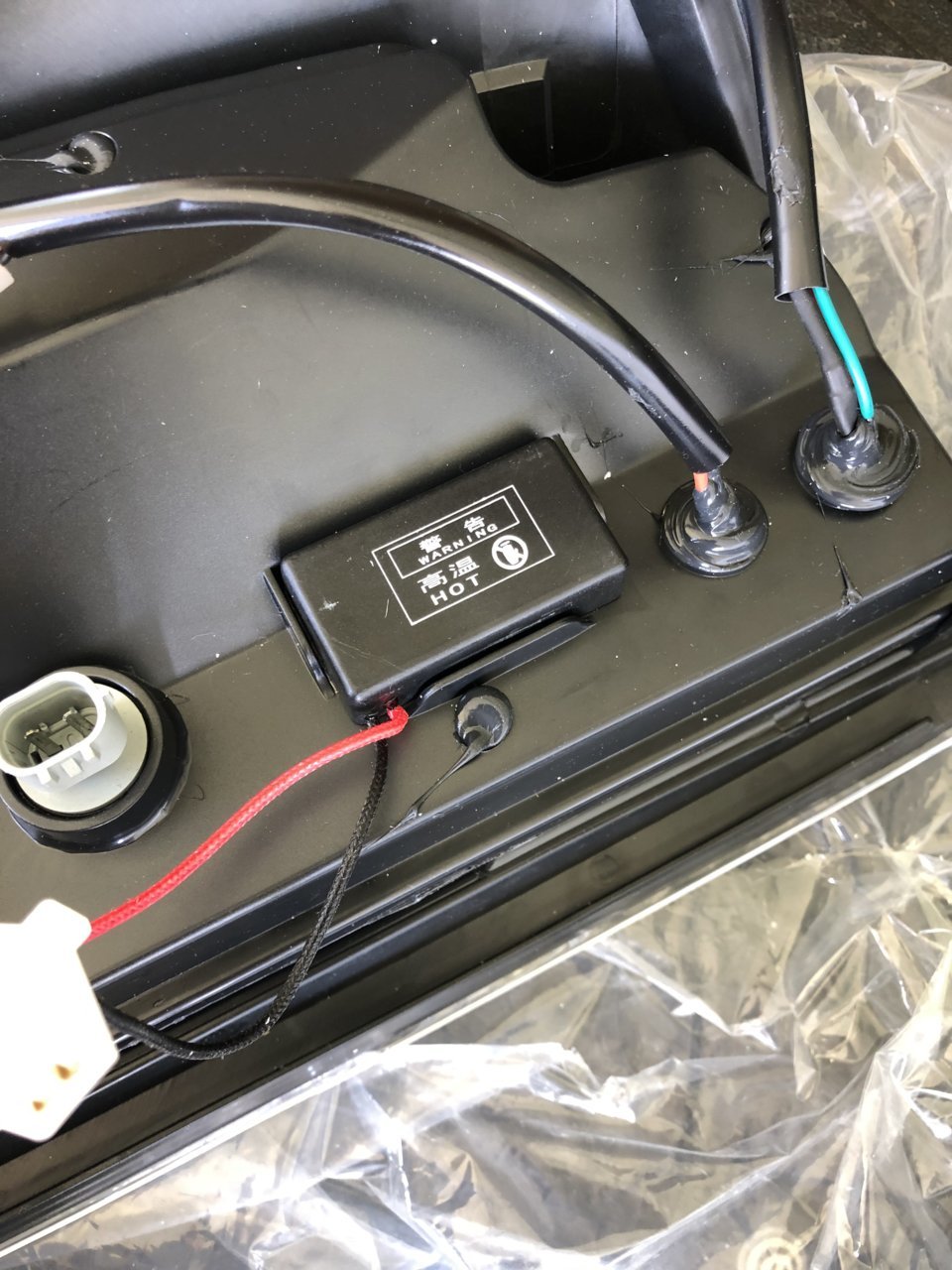

    Oddly enough I did not have to add resistors to my truck and I've got LEDs everywhere. When I went to Winjets the thing I did notice were the little LEDs on the side fell down and I went in there to find the LEDs and the circuit boards were held in place with hot glue. Pulled all that off, super glued then put back together. Problem solved. I have had zero issues since.

    Ok guys. Just sent my winjet taillights back. Gonna take a few days to get a refund. Need to know what’s out there. Looking for a slick looking light replacement with Full Led capability with no replacing bulbs. Don’t want to install resistor in factory harness either. Anything out there worth the money that fits the truck snug. Those winjet didn’t seat up to body of truck like Oem. Pic for attention and info you guys have any suggestions.

    This happened to me as well. I was going to throw them away and get new taillights. I fixed them instead and no problems.
    I have a 2018 Sport and no hyperflash.
