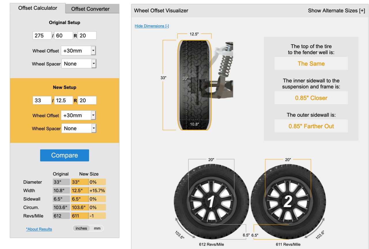

    Diameter is the same but the 33x12.5 are wider, over 15% wider. Here is a comparison between the 2 and a link to the tire size website: upload_2021-1-21_7-46-56.jpg
    Your wheels look to be +30 from a quick google search. Whether they'll fit or not, I can't help with that
