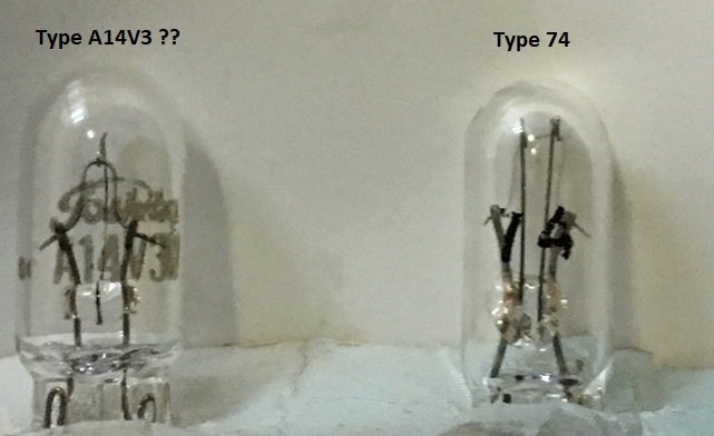

    As for the 4 questionable ones you mentioned, I replaced Check Eng and Air Bag with LED with no issues on my 04. I did not change the Low Fuel due to the circuit design. The current varies due to thermistor contained in fuel tank, which is why one sees Fuel lamp fading in and out when Low. With low fuel, the thermistor is above fuel level and heats up, its resistance drops which allows more current to the Low Fuel bulb. Also, if your year is like the 04, it's Fuel bulb is slightly bigger than a 74 and it's holder is grey compared to all others that are black.
