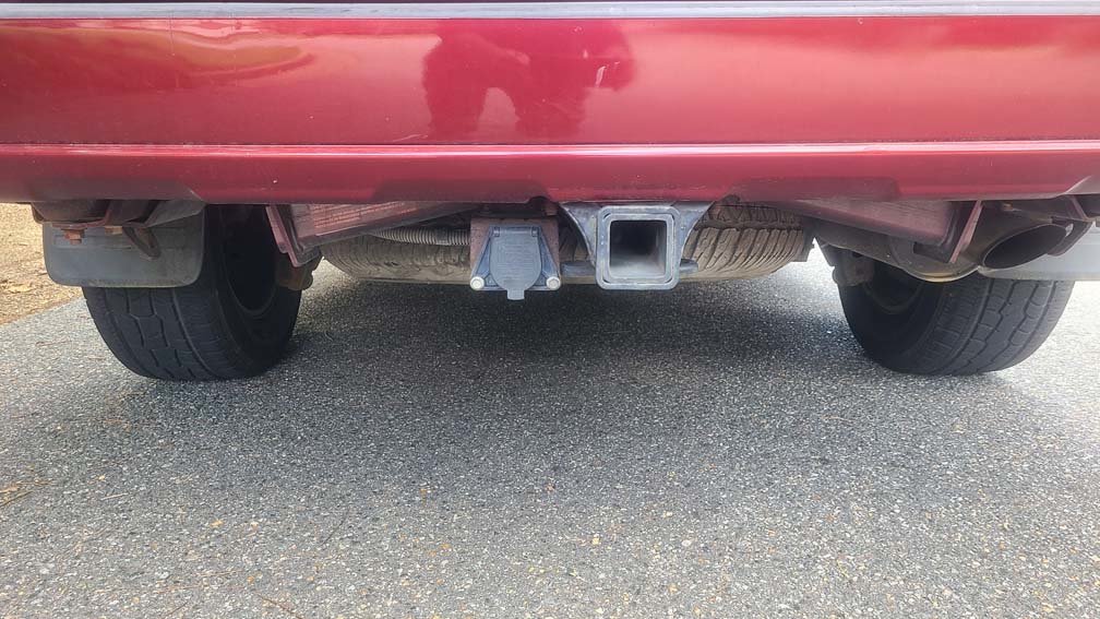

    I believe I have the factory tow package. She's got a bolt on hitch and a 7-way plug with wiring that appears factory. I can't imagine it being an add-on. It's just too well fitted.
    The hitch has a sticker with part number 51908-0C030 which is a Toyota part number. Pic attached.

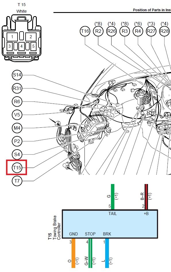

    It's a white 5 pin connector in the driver footwell area. If ya find a 5 pin connector with the colors shown below, you've hit paydirt.
    They did not make finding mine on a 04 Tundra very easy but the EWD for your 07 shows it in the same place as mine. It's not hidden like needle in hay stack but mine was not odvious. Had to get close and personal with wire harness bundle.

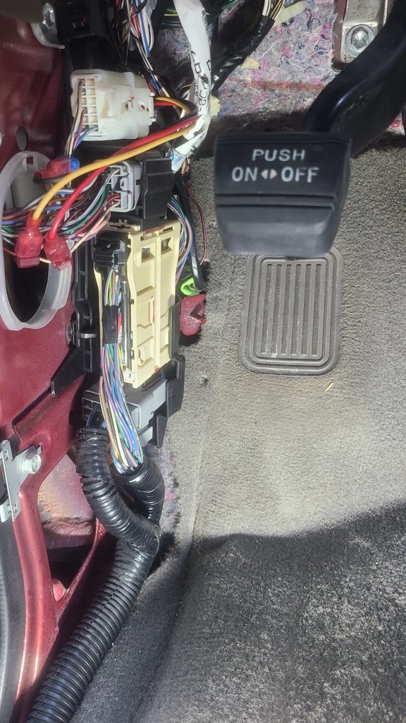

    Jeez, there's only one white connector that I can easily get to. Top of the pic on the left. It does have five wires, but they're not the same colors, and the connector is not the same shape. I suppose I need to order the brake controller kit with the harness, and see where (if) it fits.

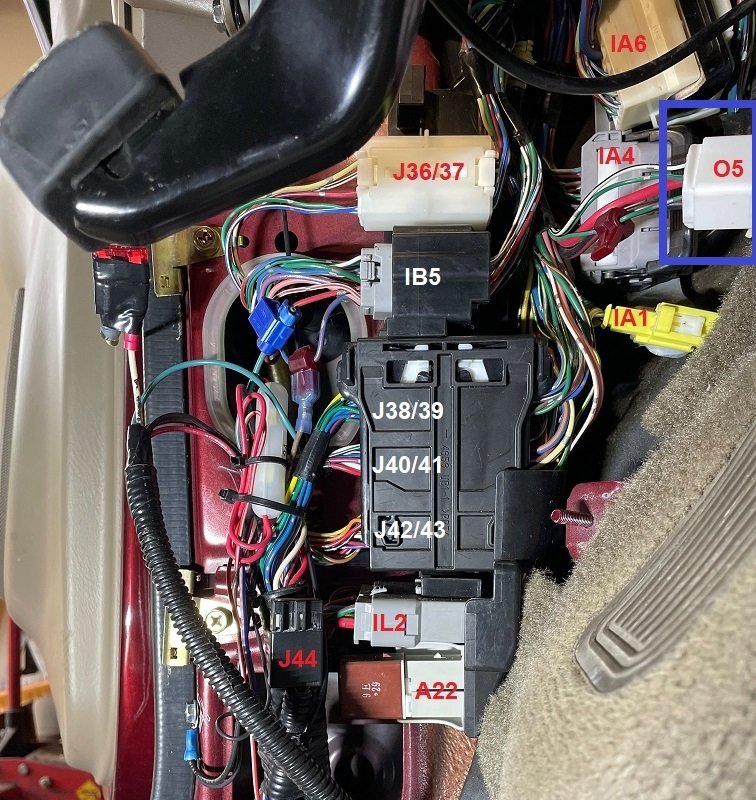

    Your 07 Seq is definitely very similar to my 04 Tun. The blue highlighted O5 connector is my brake controller plugin.
    Yours is stuffed up in the area of that bigger white connector but not easily found.

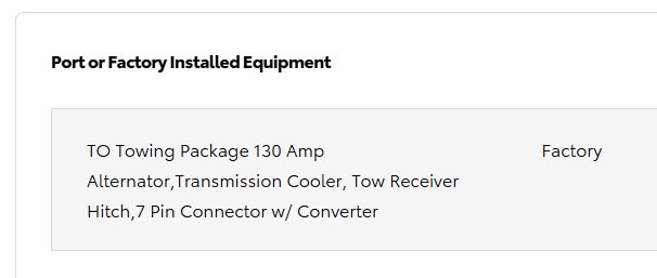

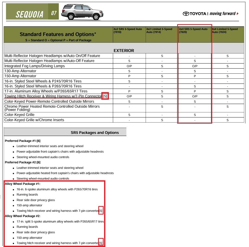

    This is what my 04 Tundra shows as far as Tow pkg which was factory.
    If we are to believe the 07 Sequoia brochure, you would have to ask yourself if any of the below are true.....07 Seq brochure attached also.

    No, sir. I am not the original owner, hence all the questions. IIRC, the hitch on our '04 Tundra was built into the frame.
    I created an account and put in the VIN. There's no mention of the tow package. However, she does have the 17 inch aluminum wheels and 265/65 tires--so it looks like it could have Alloy Wheel Package #2 as you posted above.
    The site also says it has fabric seats, but they're leather. I've got the power adjustable captains chairs without the seat heater, but no audio controls on the steering wheel.

    I found it. It was buried, above the white plug in the pic I uploaded in post #5, taped to a wire bundle with black electrical tape. It also had a blank female connector attached to it. I'm guessing it's never been used.
