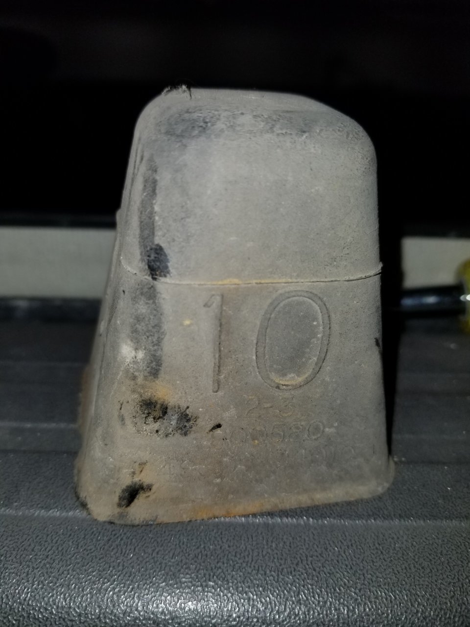

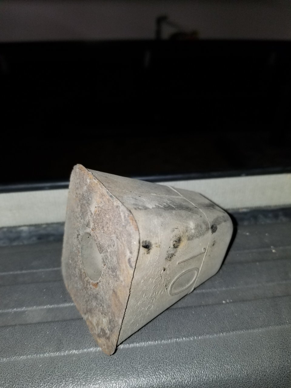

    I found it on top of the rear end wedged in between metal brake lines on the left side. I know it has something to do with the suspension. There is nothing on the right side. Guessing its along the road somewhere. I hauled alot of bulk decorative rock last fall...maybe that did it. 20190308_181835.jpg 20190308_181900.jpg

    Looks like a bump stop...

    That sounds right. Not sure how or where it was exactly. There is no mounting hardware. It must have been glued in place or wedged somehow. It could have been there since they replaced to frame.

    Yup bump stop, it's held down buy the axle u bolts.

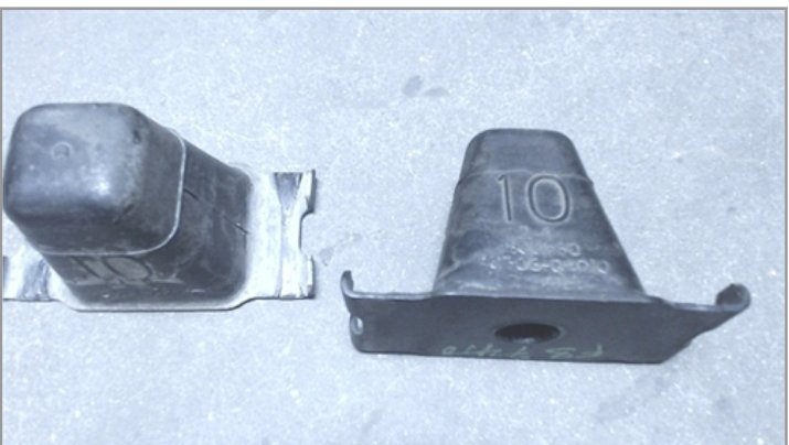

    Bump Stop (top of u bolt) Picture is a random one I found from Google.

    The u bolt goes around that lip and holds it in place.
