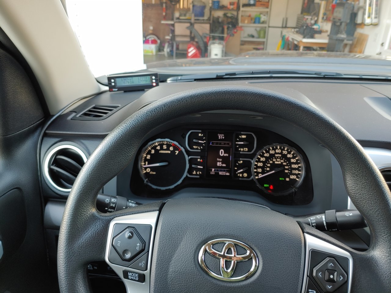

    How did you route your cable? I like that location... Is it easy to change gauges from that position?

    I popped out the panel on the side of the dash and the speaker cover. I think I took the speaker out and then ran the cable down from there. It was fairly easy, but a slight PITA to route. Then wrapped the extra cable up under the dash. You have to lean forward from the seat to change it, but it's easy enough if you're parked. I like having it as far forward as possible; easier to do a quick glance while driving that way.

    Thanks for the info. I'm not one to mess around while driving so that would be perfect for me.

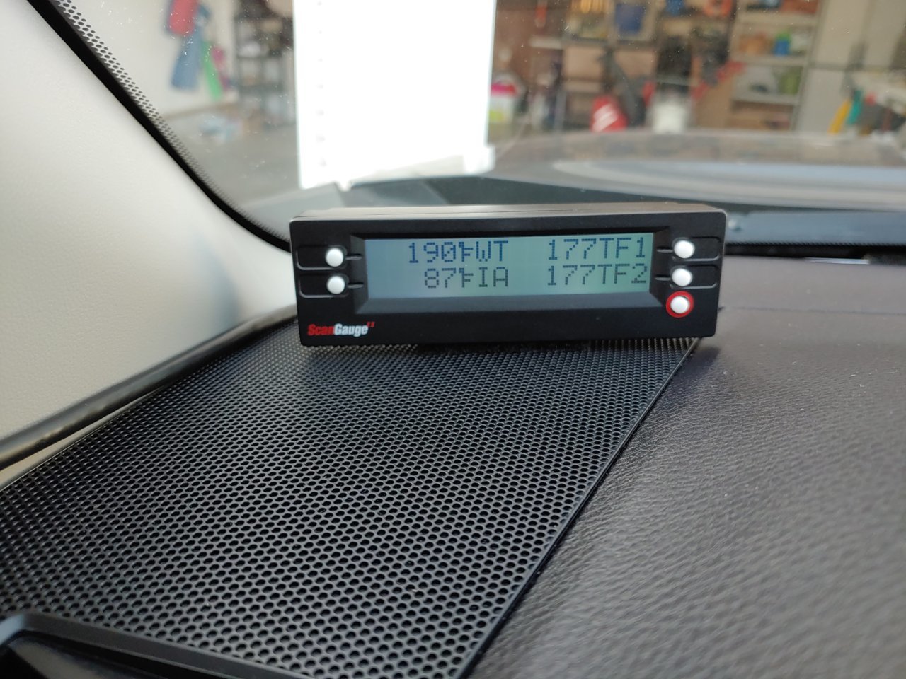

    After reading through the codes on the website, is that supposed to be 3008 instead of 3808? I used 3808 and it is reading slightly higher than 2808, but the website only has 3008, not 3808.

    I'm using the one that HTGreen had posted a while back and they are correct and accurate. I think the website doesn't have the complete info.
    3808 is the TC temp and will typically read higher than 2808 (pan temp).
    if cruising and TC is locked, both temps should read the same.
