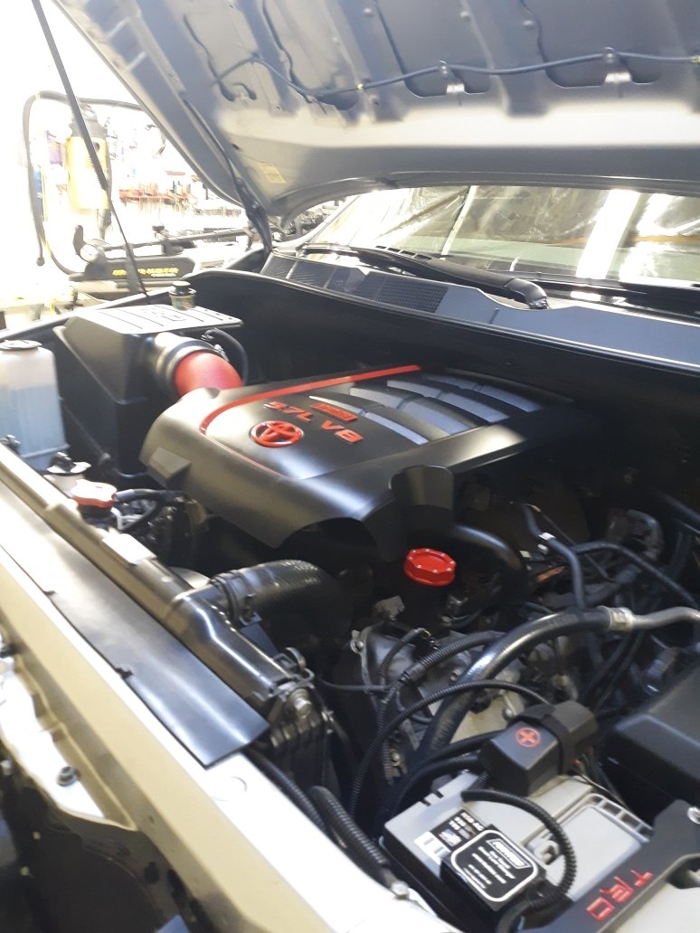

    Not nearly enough room here!
    I had this rubber laying around in the garage. :D Resized_20190717_175452[6923].jpg

    I like this idea best. It looks like a permanent solution. Is it glued on since I don't see any hardware. I think it would need to come off the next time I pull the radiator to do the timing belt. Otherwise I'll have to see what my local stealer wants for the OE foam.

    3m tape. some site prep and cleaning but easy. you replace some clips that hold a wire harness underneath (ie, not visible) but the kit provided some tie straps with 3m to use instead. believe it or not i found the guys contact info and asked if he's still selling them. will let you know if i hear back.

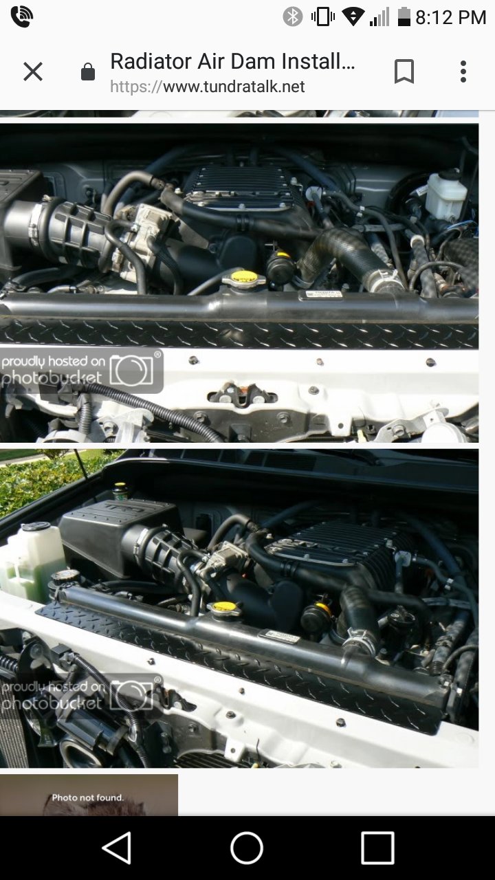

    That was one of the first things I did. G-Tek Fab Diamond Plate Air Dam :cool:
