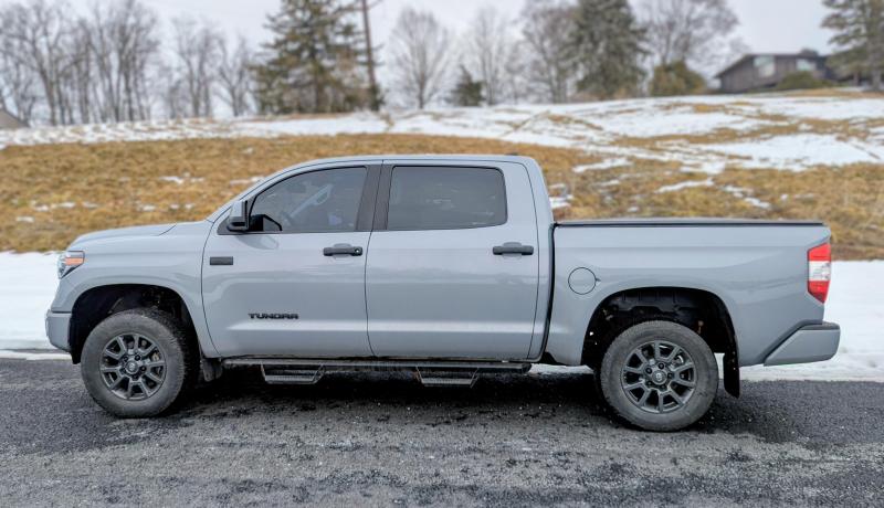

    Took the extended weekend and warm weather (above 32* lol) to install the 6112 and toytec shackles that have been sitting in my garage since black friday. I had Hotshot Offroad set them at 1.9" and am using 1 coachbuilder spacer on the driver side.
    I rented tools from Advanced Auto to push out the rear leaf bushing, which worked great. I did run into a bunch of small hold-ups, which I anticipated. 30k miles on the truck and the rear shocks just did not want to cooperate. I am doing this in my driverway, against HOA rules lol and almost threw in the towel. Then I got out the BFH and angle grinder and just destroyed the rear shocks. Rear was done Friday afternoon, front was done Saturday afternoon. Alignment was done today.
    Front: 6112 @ 1.9" w one spacer on driver side
    Rear: toytec shackle set at 1" (option of 1.5" also), 5100 shocks
    Before: driver front 36, pass front 36.5, driver rear 38.37, pass rear 38.25
    After: driver front 38.25, pass front 38.5, driver rear 40, pass rear 39.5
    So I STILL have driver side lean and the spacer did not get me where I wanted

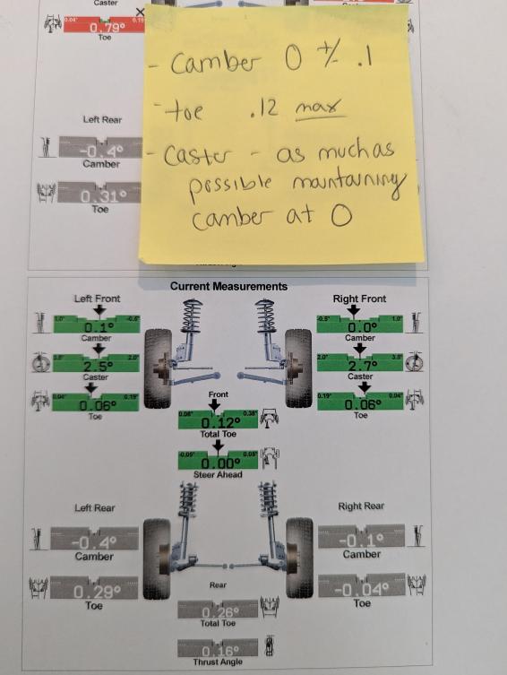

    I just got back from CJsTire for alignment. Post-it note was what I asked for. ANNNNDDDD of course I ordered Nokian Outpost nAT tires in 285/75r18, which will be in next week. I was going to go with my favorite Falken Wildpeak at4w, but the weight scared me off. This is my daily driver and I still need some pep and gas mileage. I have the Banks throttle controller which will help some.

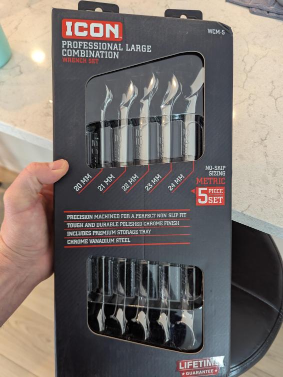

    I stopped at everyone's favorite tool store to get a large wrench set. I didnt have a 24mm to loosen the front LCAs and that was a PITA. I used the 15% off any item to buy the pictured wrench set. I'll grab the SAE large set next sale.
    Current state post-lift w OE 265 tires.

    Interesting your rear shocks caused you issues. Did mine in like 30 minutes and I had 85K on my truck. What in particular held you up? I had way more trouble with the front coilovers. Wasted a bunch of time by trying to slip them in without loosening with the LCA bolts, that was a mistake. Ended up smashing my pinky getting the passenger one in. All the guys prying down the LCA's on the instructional vids have lifts and I guess I couldn't get enough leverage on the ground.
    Looks good though!

    My go-to tool store

    where’d you get the alignment numbers from? And still on factory uppers?
    edit: yes I know you don’t need new UCA unless you’re hitting 2.5”, but just curious

    The alignment numbers were from threads on this forum. Yes, factory uppers. One of the reasons for staying under 3" was to keep the factory UCA, no dif drop, and front sensor friendly. Aftermarket are just too expensive for what it is and require regulare maintenance.
