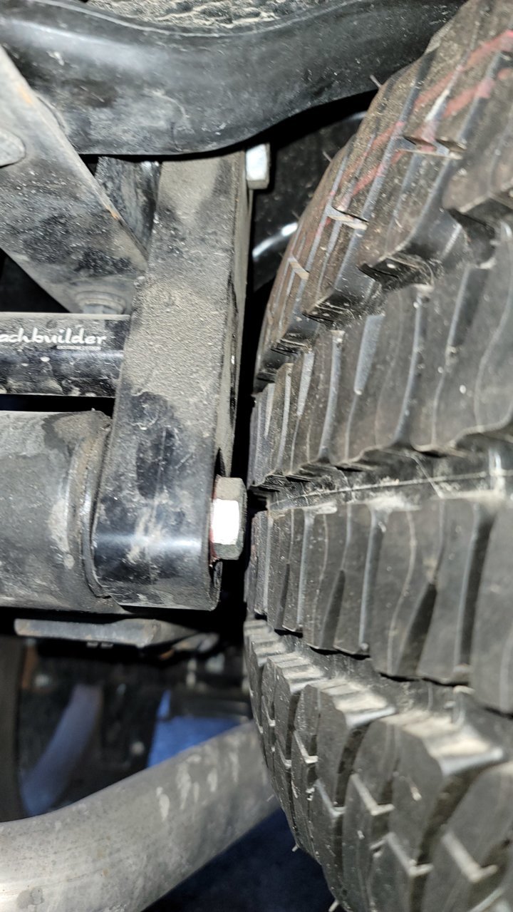

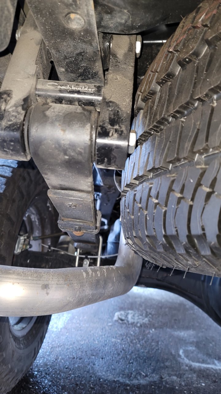

    On A tundra pro 2020. Coachbuilder +2 shackles. Anyone experienced The back driver side shackles to dam close to the spare tire i cant even fit my finger throught it. Is this normal?

    Looks like a stock size spare. You should have plenty of room up there. How does the space on the other side look? Maybe loosen the spare and shove it over a bit and re-tighten?

    Its a stock tire. The other side has plenty of space. Maybe it could be the spare tire thats out of place. Ill give that a shot. Thx 4 the fast reply

    No problem. I think it just needs to be repositioned and you should have room on both sides after that.
