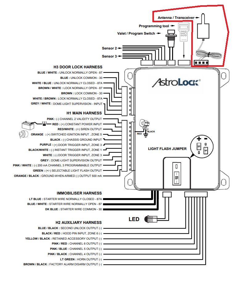

    Pretty sure it's Astroflex remote start and/or alarm module. A lot of people don't know about Astroflex/Astrostart, I don't think they've been in business for a decade or more. Canadian based company. I'm pretty sure if you peel back that white sticker it'll say "ASTROFLEX, INC" as a whole.

    The shop I worked at installed Avital and Clifford, both owned acquired by DEI also. It would appear DEI either owned or owns Astro at this point. I did a little extra digging at their website out of curiosity, and sure enough, there's a few Astroflex manuals on there... although I'm not sure when DEI bought them. DEI's website does list AstroStart on their website. Here's some older manuals I found:
    If you want to dig through manuals to see if you can find yours, try this search for starters.

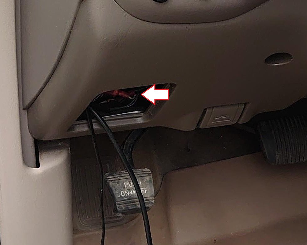

    But I think what you have specifically in the circuit board is going to be the antenna or transceiver module as @Leo's first said. And I see LOTs of shitbag t-taps up in teh dash thru the hole in your pic ... you've got some series repair to do.

    I'm not 100% on this, but to me, it looks like the kind of cable you'd typically see for A/V applications or for RS232/Serial/PS2 applications, as if maybe it was part of an integrated system for backup/dash cam/microphone or similar? Or maybe a diagnostic/programming port? Maybe that's what they used for glass break or something? I really don't know.
    I suspect if OP gets up in that dash, he may find a similar module to the one in the picture I pasted.

    But yeah, note the T-taps. I couldn't see this on my phone earlier while I was stuck in the hospital. Screen too small. I bet there's a goddamn mess of hackery, birds nest up in there. The brain is somewhere... gotta trace the wires back... May also be tucked in the driver's kick panel.

    It probably didn't replace the OEM system. The aftermarket system was probably used because the OEM system only handled lock/unlock/intrustion and the owner wanted more.
    You may be able to go to DEI's website and find one of their preferred AutoStart dealers and have them unwire the system. I'd personally prefer to do it myself because I'd re-solder and heatshrink the connections, but ...
    You'll probably find the install isn't limited to under the dash. There will probably be simple relays in each door, for window and/or lock control via the alarm brain.
