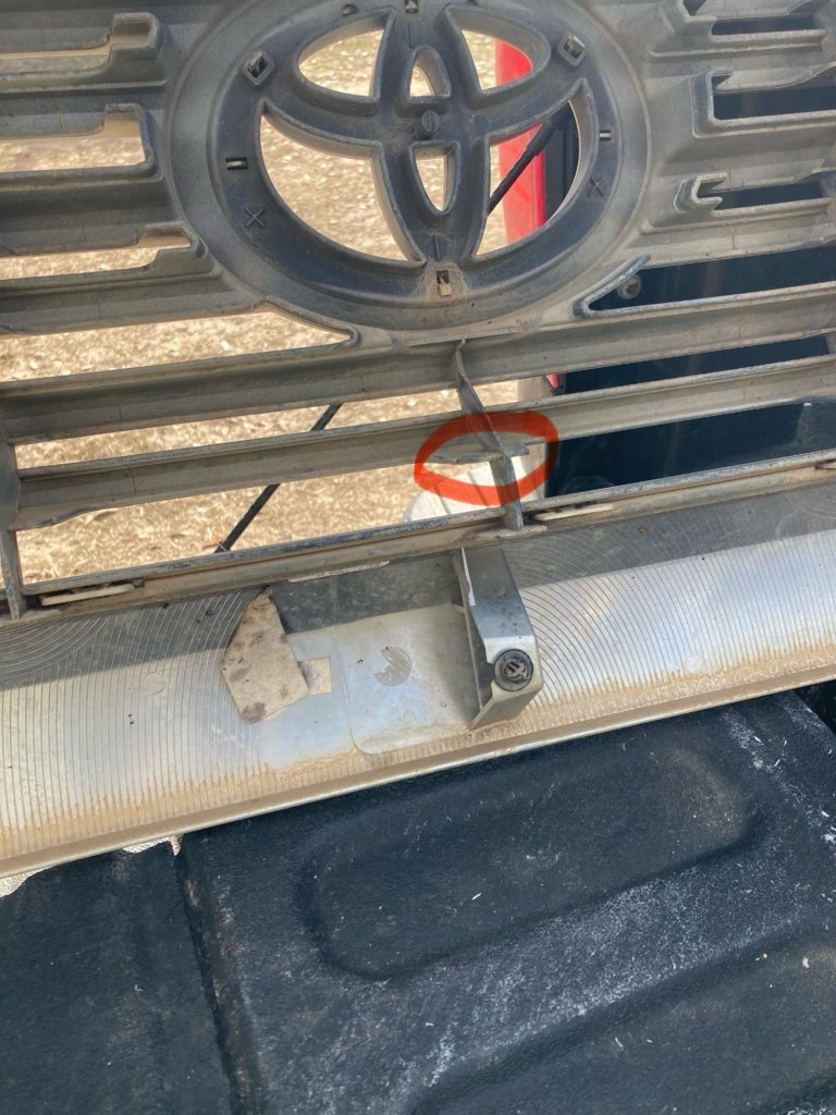

    Anyone mounted the anytime backup cam front camera to a limited grill? The cam does not fit my truck now im lost on how to fabricate a mount for it…please someone help

    What camera are you using?
    the first time I pulled the grille, drilled holes to line up with the mounting bracket and bolted it on.
    the second time I used a push-in round style camera and cut a hole in my faux TSS cover to mount it.
    you can zoom in on these pics for an idea of what I’m talking about.

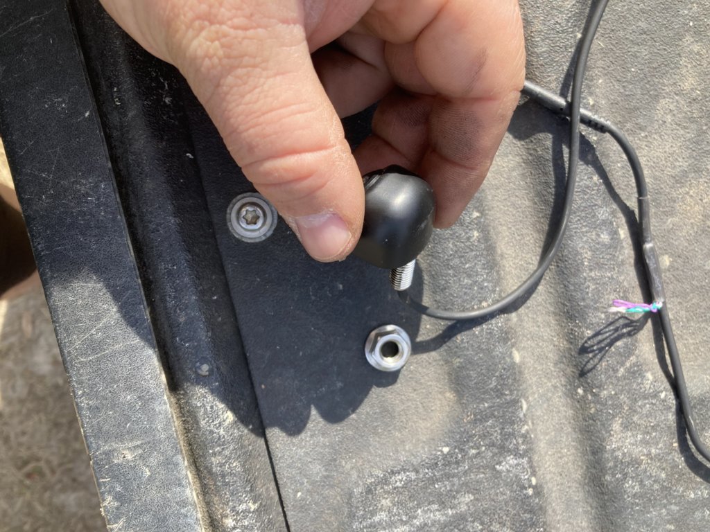

    Mine didnt come with a mounting bracket its just a camera and a bolt imIMG_8736.jpg

    Im trying to find a place to mount it but theres nowhere to drill into on my grillIMG_8737.jpg

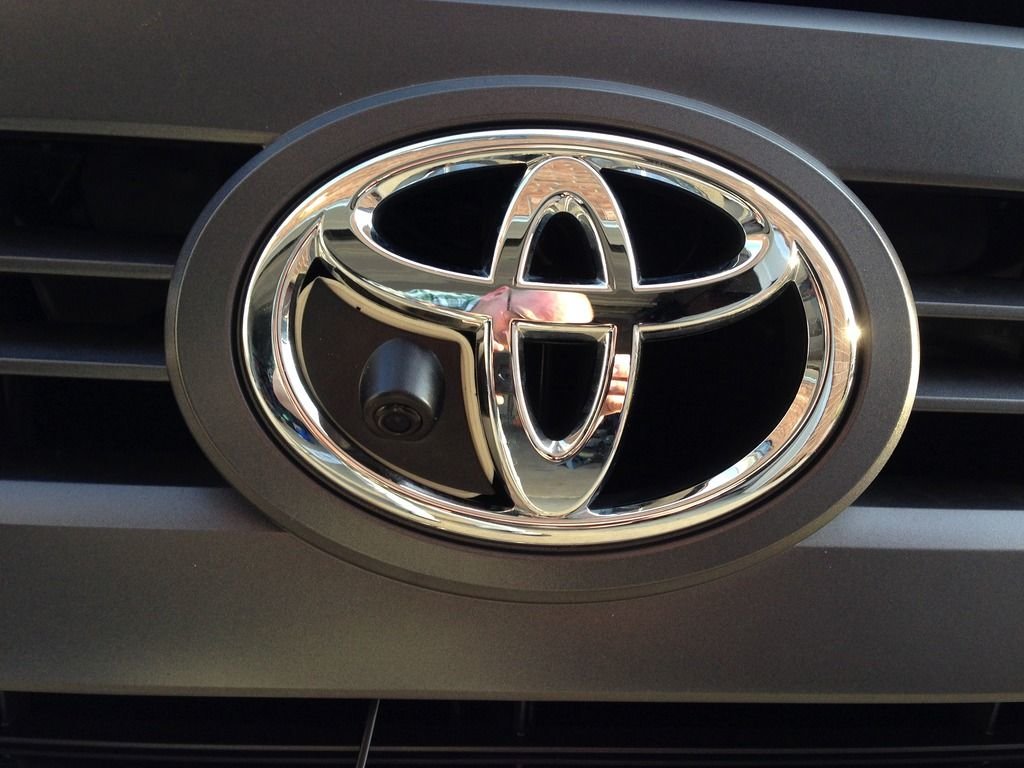

    Where did you get your camera from? It looks like the same kit I got from Trail Grid Pro. If I'm not mistaken, the camera is "clockable" in that you cut a certain wire in the harness to let it know its mounting orientation. With that being the case, could you mount it to the bottom of the emblem or something?

    I drilled and mounted to this but I had two small mounting holes to the side not one in the middle…
    Is there room in front of the brace? Obviously you’d need to drill from an angle…

    Around this blue dot?
    make sure the nut will fit.

    Thats what i ended up doing mine does something wierd though when switching back from front camera to the nuetral position on the switch it always goes to the rear camera before switching off i dont understand why it does that does your do it? I ordered mine from caliraised led
