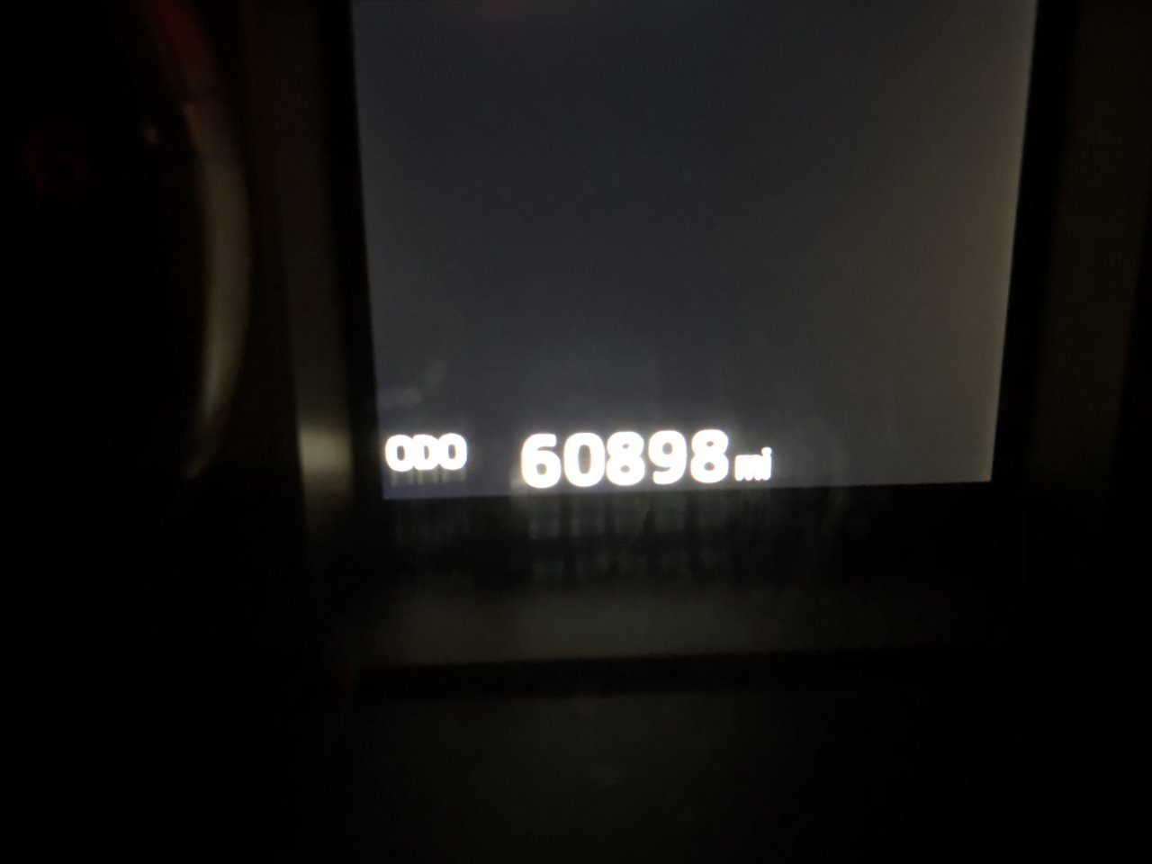

    This just happened and I just passed my 60k warranty. I’m at 61k Dang it!
  2. Jul 28, 2018 at 8:51 PM
    40,565
    Figures... Surprised it didn't last longer than 60K. I bought a spare pump to use when mine goes. I'm at 91K. A typically terrible location to DIY. Lots of labor involved. I dread the day when it's time to replace.

    Just snap a picture of the mileage. Lol
    I’m having a my colleague brother look into it Monday. He’s a Toyota Mechanic. Helpfully he can help me out.

    I'd think Toyota would work with you on a warranty that's just over 800 miles past. In this day and age they know how much a "bad Yelp review" could do. It would hurt them more than helping you. Plus it brings back a return customer.
    If they say no, use my post as an example that they should fix it.

    Went to get it checked and he said I am good. Nothing to really worry about. He said if Toyota won’t cover it under warranty he will do it for $230.
    Not bad.

    Big shoutout to Toyota Corporate and Tustin Toyota for replacing my water pump under warranty when it is out of warranty. :)

    Glad you were taken care of, I think it’s safe to say from the staining in your photo that it had been happening for a little while before you discovered it.

    It’s usually only the gasket leaking, but Toyota typically replaces the whole thing if they do it under warranty. Just had work done on my timing chain and they only replaced the gasket on my water pump.
