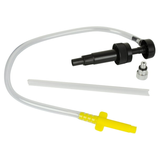

  8. Apr 27, 2023 at 9:13 PM
    JLS in WA
    JLS in WA New Member
    Jan 1, 2020
    #40610
    1,393
    Somewhere in the basalt rocks with my dogs
    2008 White DC Limited 4x4
    Drahthaar Transport Unit
    Legoro_1986 likes this.
