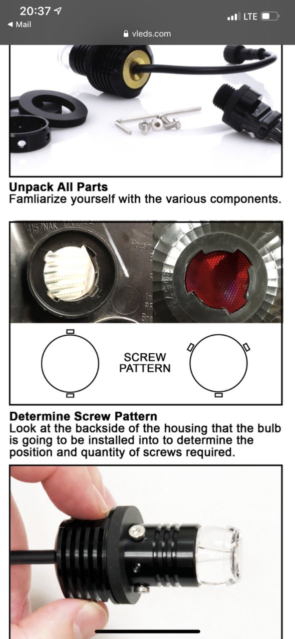

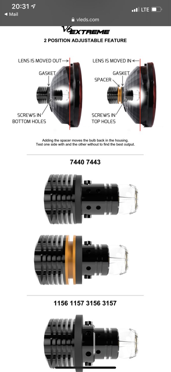

    Have you looked at this and tried using spacer. C1366BDB-0D50-4819-AF7D-9DCA306E7ADB.jpg

    I think I had to use spacer, and switch screws around to align with holes.

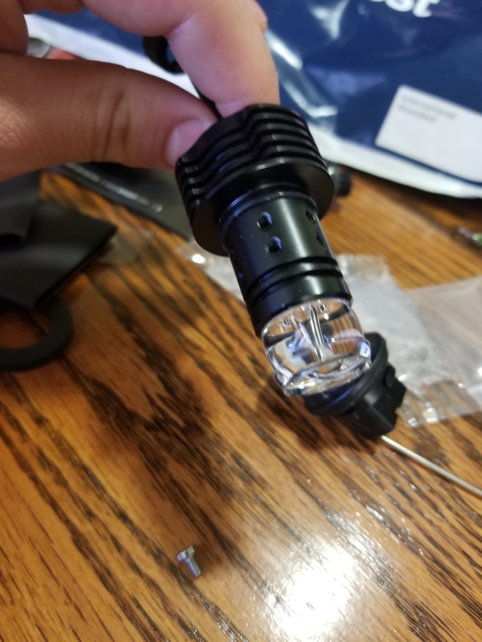

    Agree, I think I may have used only 2 as well. FCEE193F-5173-4425-B976-98E7FD75781C.jpg
