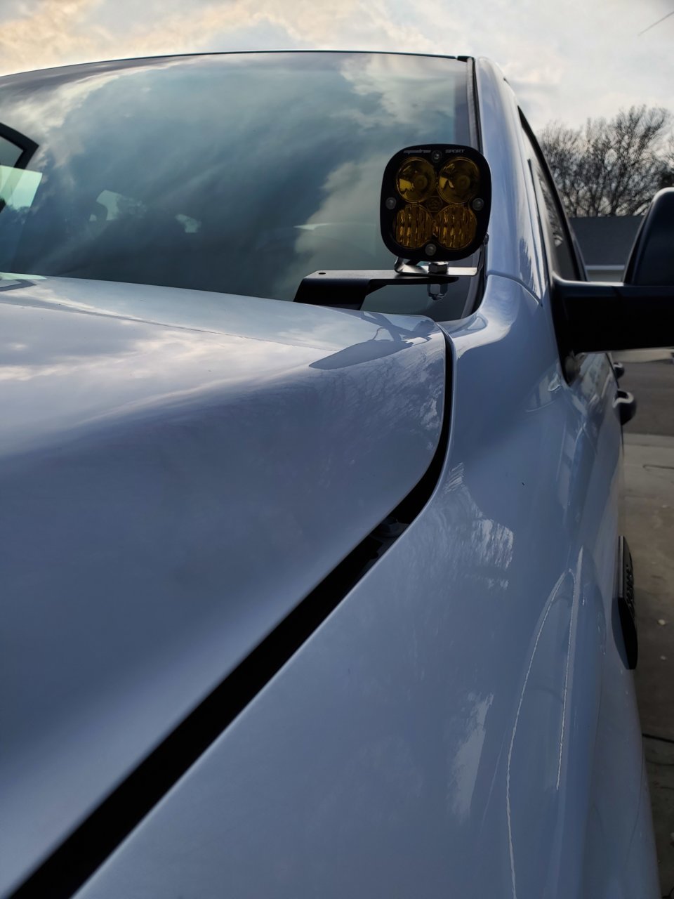

    Is this the way they are suppose to sit? Post pics
  2. Jan 25, 2020 at 4:58 PM
    Pinay
    Pinay New Member
    Sep 14, 2018
    #19379
    11,446
    Monet
    Mahal kita Kuya
    They should point to the sides of your truck.
    Or are you asking how the bracket sits?

    When you lift and bring the hood closed is it hitting anything?
    Rica25[OP] likes this.
  4. Jan 25, 2020 at 4:59 PM
    Rica25
    Rica25 [OP] Got Bam? IG ......@TNDRA08
    Dec 6, 2017
    #11380
    5,532
    Ricardo
    Tulare
    Do they seem to be to high?
  5. Jan 25, 2020 at 5:00 PM
    Pinay
    Pinay New Member
    Sep 14, 2018
    #19379
    11,446
    Monet
    Mahal kita Kuya
    Is the hood closed on the first pic?
    Rica25[QUOTED][OP] likes this.
  6. Jan 25, 2020 at 5:00 PM
    Rica25
    Dec 6, 2017
    #11380
    5,532
    Ricardo
    Tulare
    Nope the are about 1/4 of an inch from the windshield

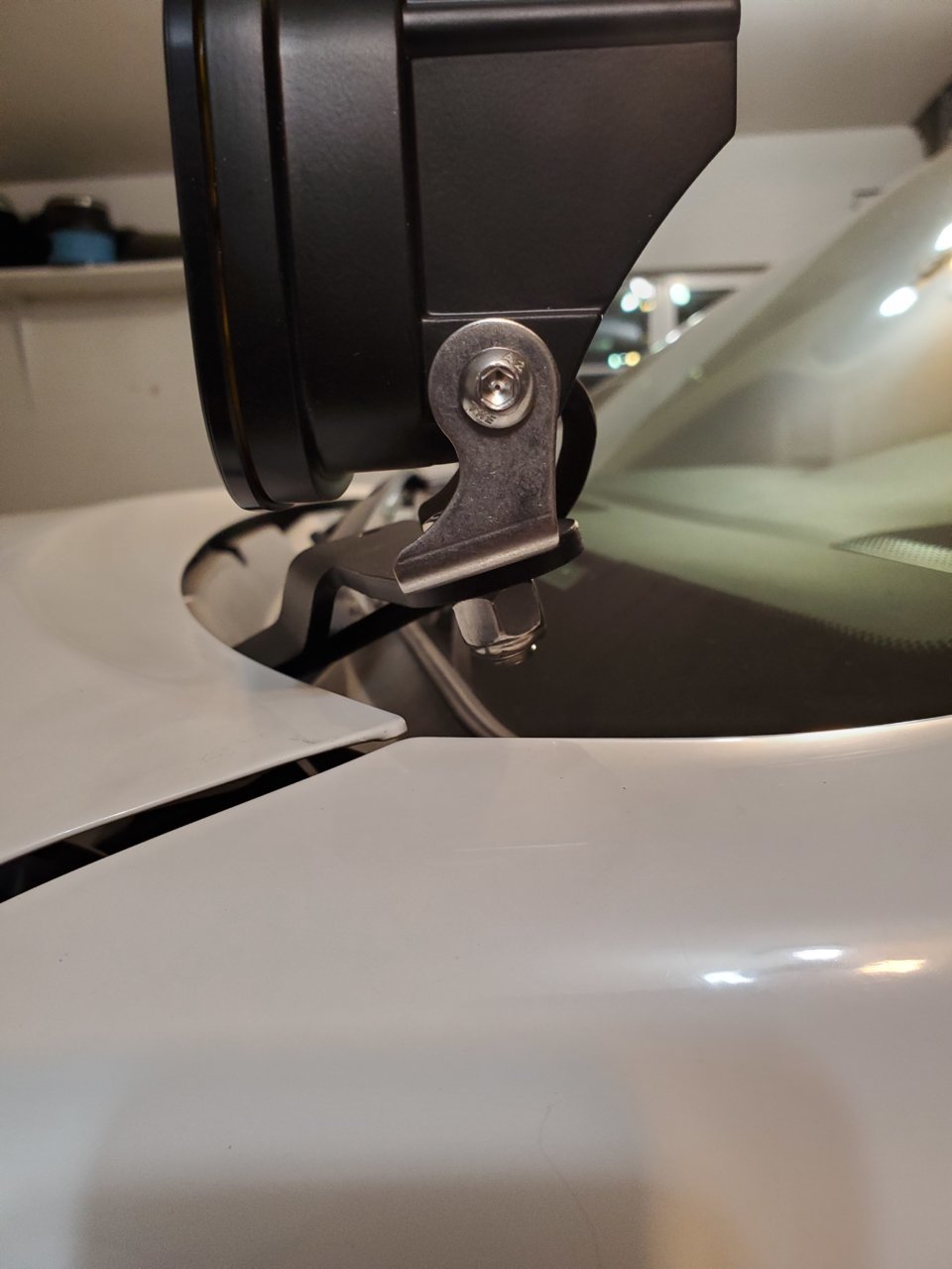

    Yes it is because of the the bracket being thick it makes it stick up

    Did you install the bracket between the hinge and the hood?
    My Rago brackets (and others) mount under the hinge (so the hinge still contacts the hood). The brackets should not raise the hood at all.
    porkitt and Rica25[QUOTED][OP] like this.

    Hmmmm....ok comes with no instructions but I will look at some videos and yes installed between the hood and hinge
  12. Jan 25, 2020 at 5:11 PM
    Squatting Pigeon
    Apr 14, 2018
    #14443
    52,461
    Holden
    North Texas
    Luxe Trail Pig
    X2 on what @sr5shark said. The bracket should be at the very bottom, and you'll be good to go @Rica25 :thumbsup:

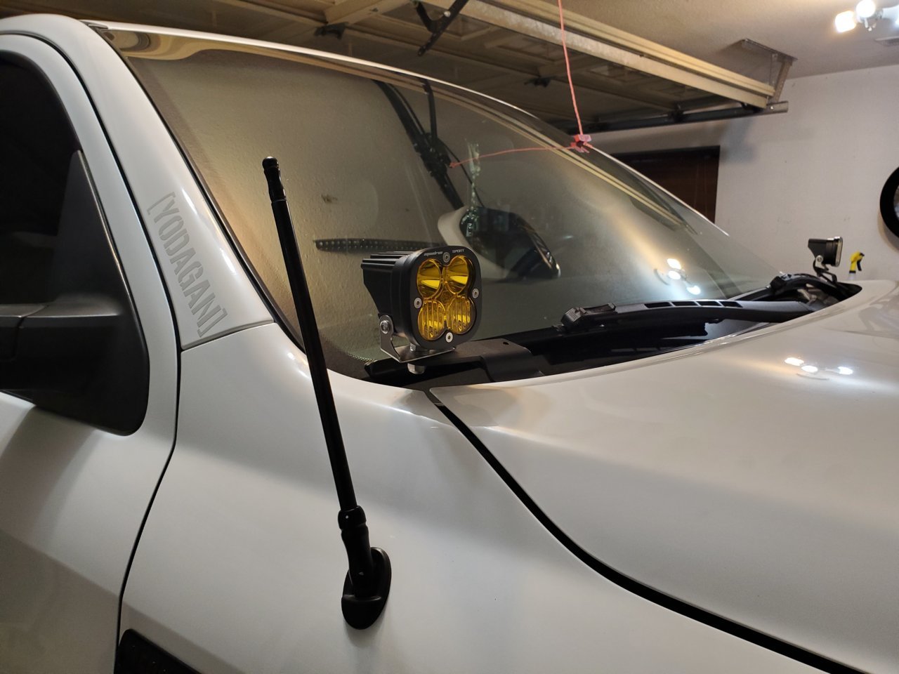

    That’s what’s pushing the hood up out of alignment. They should be like this:

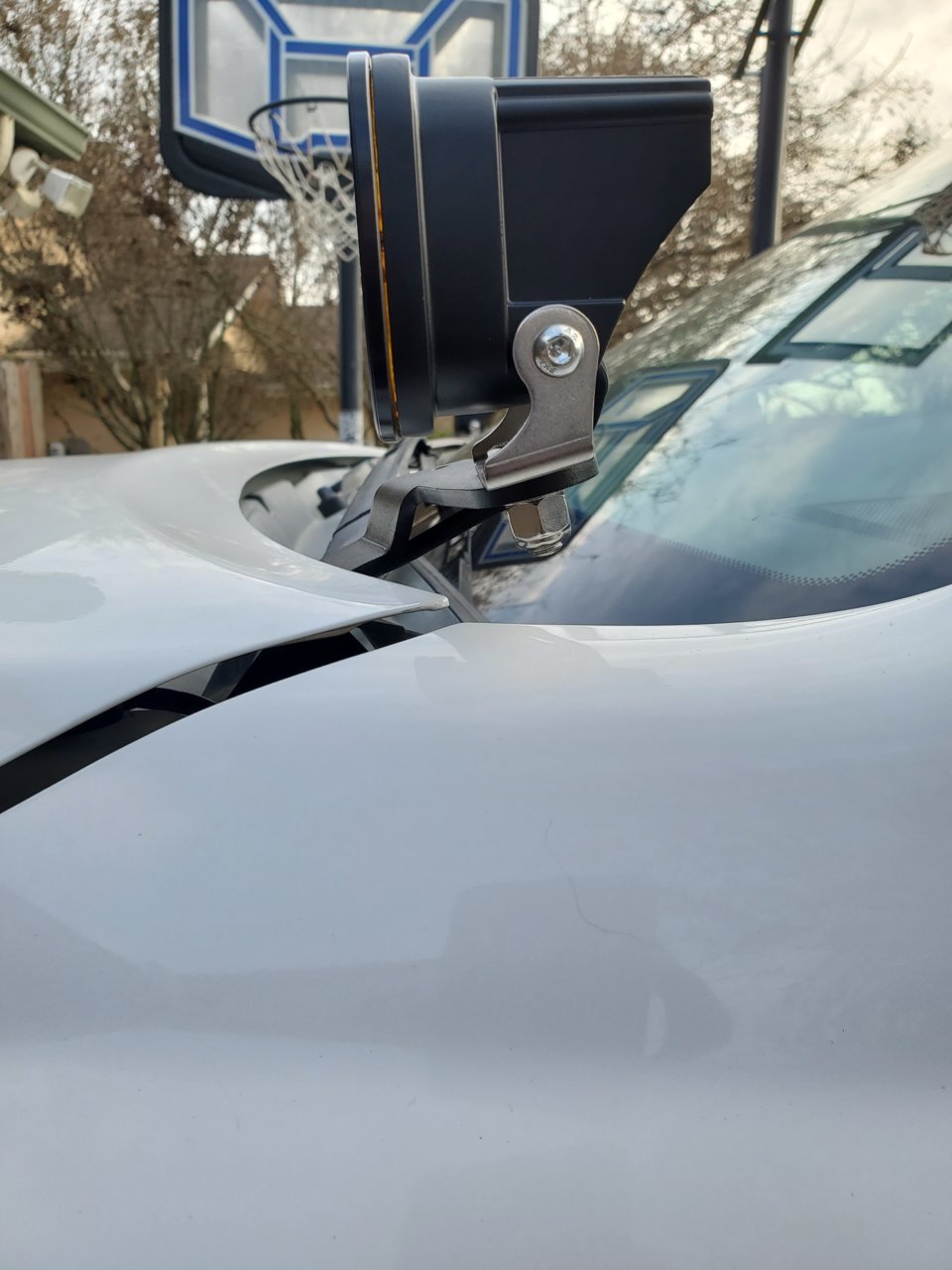

    Ok I'll fix them right now
    Pinay and sr5shark like this.
  15. Jan 25, 2020 at 5:37 PM
    Rica25
    Dec 6, 2017
    #11380
    5,532
    Ricardo
    Tulare
  16. Jan 25, 2020 at 5:45 PM
    Rica25
    Dec 6, 2017
    #11380
    5,532
    Ricardo
    Tulare
    Much better now thanks

    Looks good! :thumbsup:

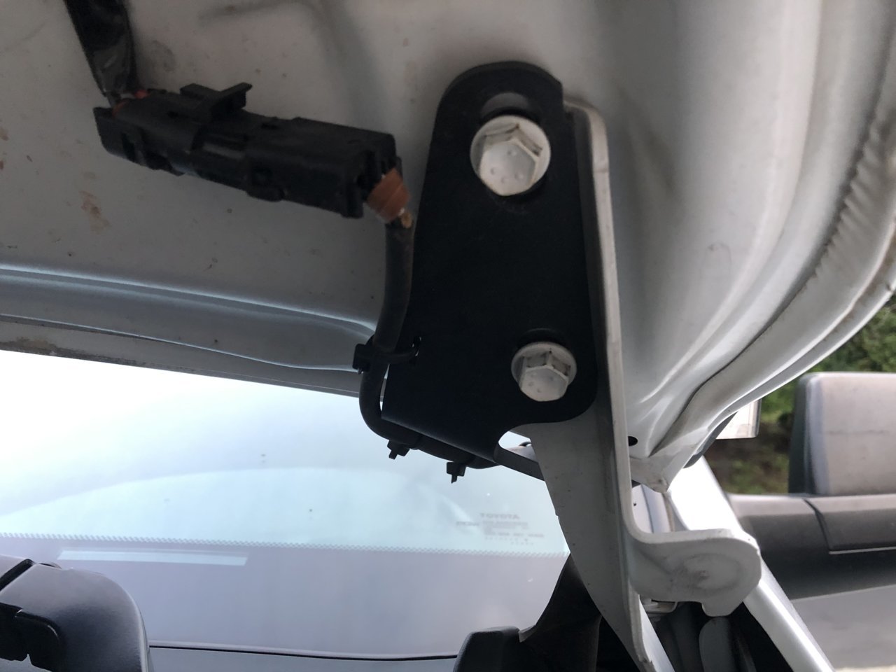

    How did you guys run the harness for those that have BD as ditch lights they barely reach each other. ?
  23. Jan 26, 2020 at 8:17 AM
    Rica25
    Dec 6, 2017
    #11380
    5,532
    Ricardo
    Tulare
    The connection to the BD light seems to kind of be seen from the top of the hood

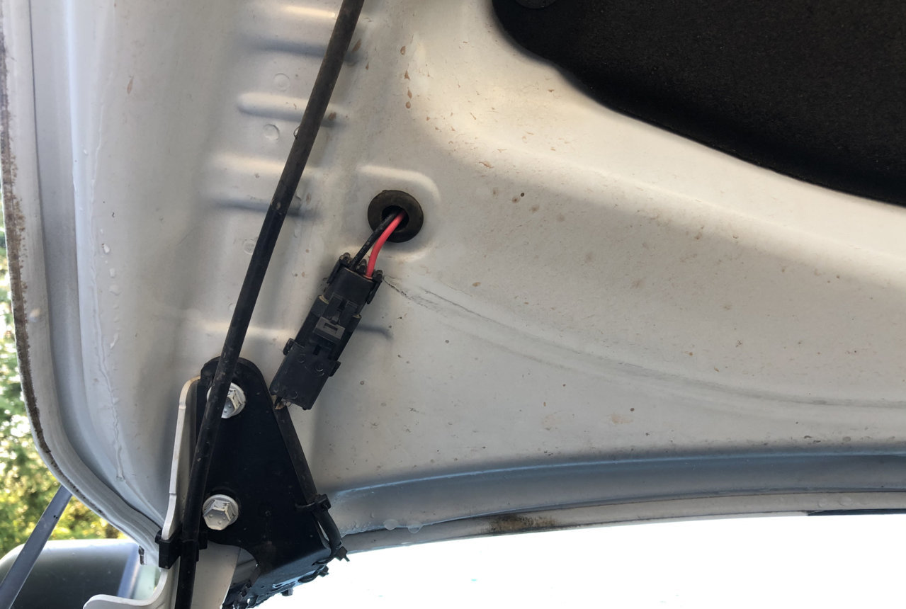

    I used a fish tape to run the wires from the passenger to the driver side through the hood - there are holes on both sides near the windshield. I also installed a rubber grommet.

    run under the cowl hood. they barely connect to each other. Like you found out.

    yep. they fit but you gotta route them properly. Not much slack left when connected.
