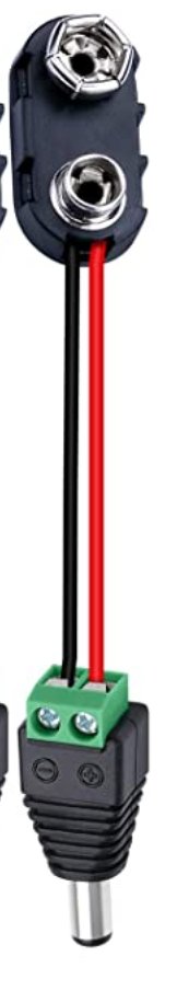

    A great thing about these portable oscilloscopes, is that they can be run off a 9v battery to make them portable so you aren't running an extensions cord out to your truck if its not in the garage. I remember i calculated something like 3hrs of use on a 9v battery (something like that).
    Grab one of these 9v to barrel connector to make things easier:
    https://smile.amazon.com/gp/product/B07YBYL7HH?ie=UTF8
