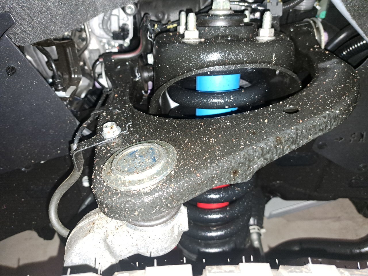

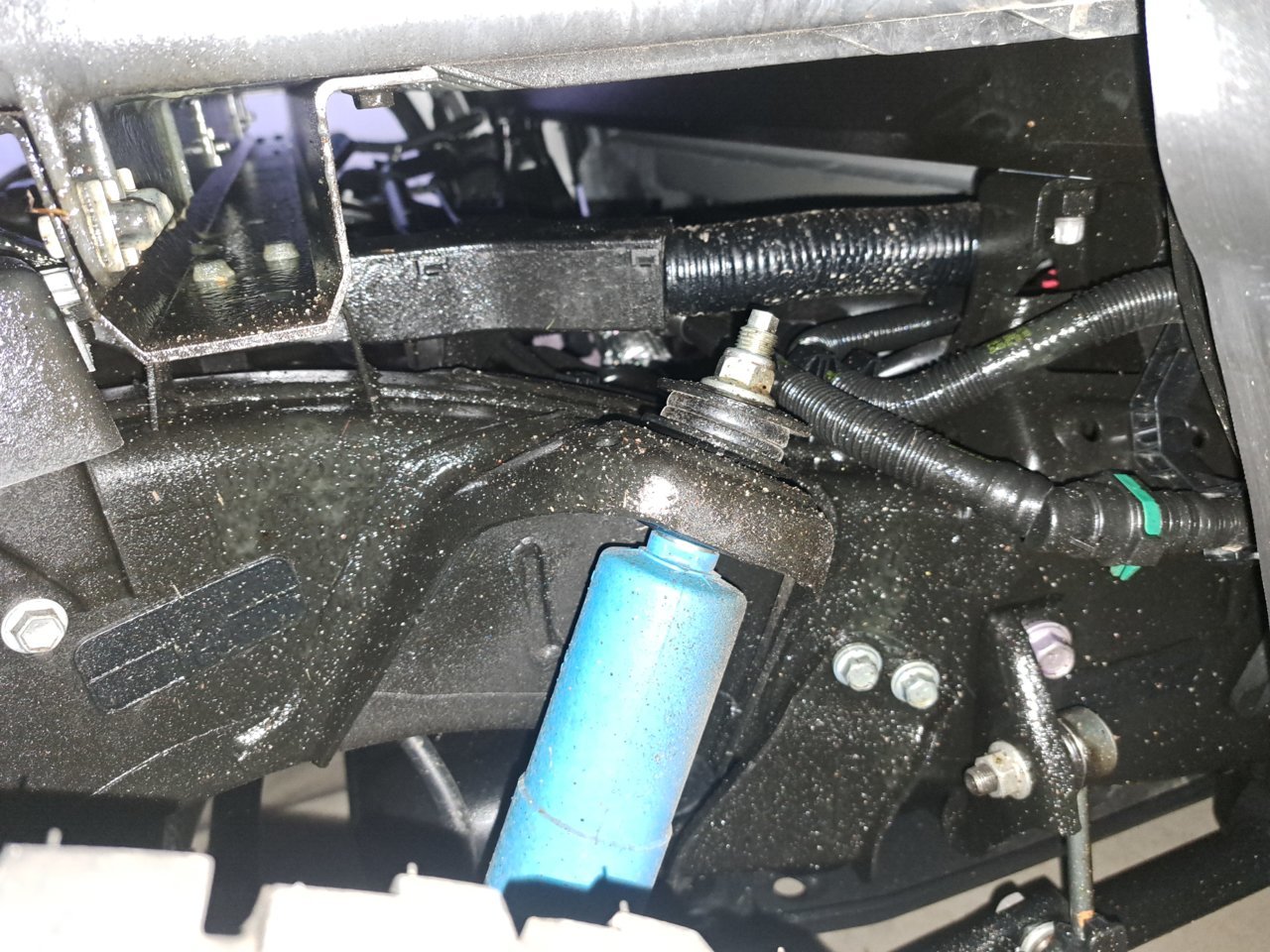

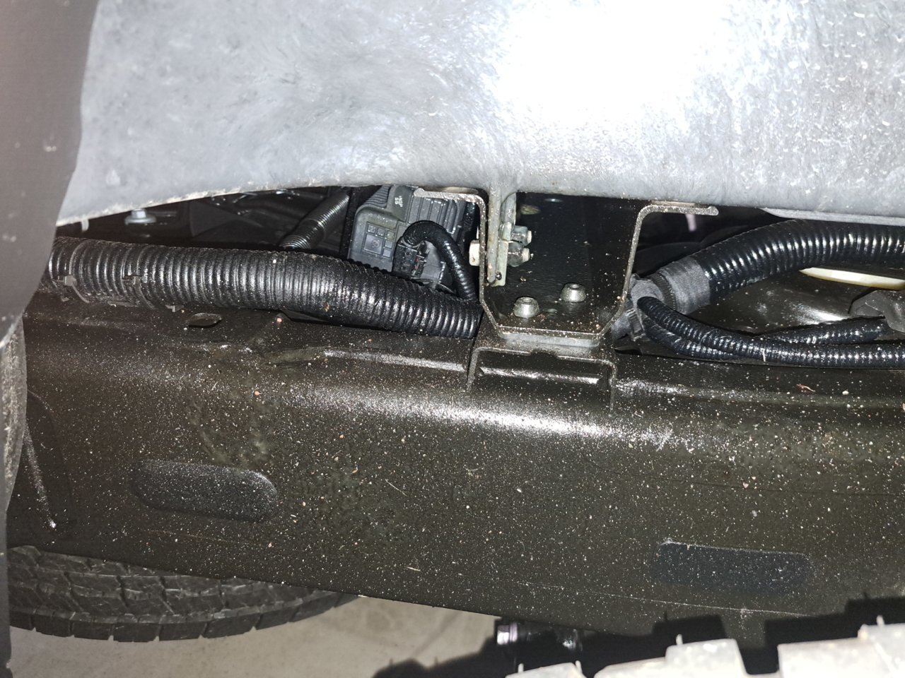

    Mine got the Waxoil treatment when it arrived at the dealer from the factory,after a year they want it back for inspection and touch ups if needed, I'll tell you this though, if you have to do anything and I mean anything under your truck ya better wear a Tyvek suit cause that shit sucks to off get off it gets EVERY WHERE!
    I can appreciate for what it does but man swapping out my exhaust sucked I was covered in that shit.
