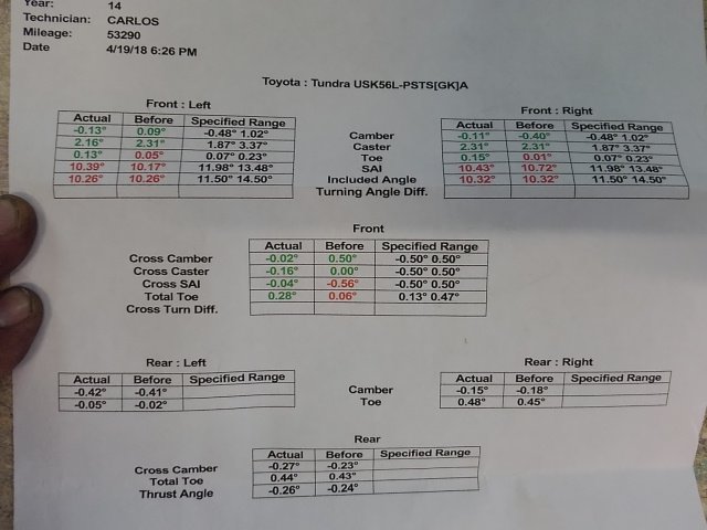

    I'm on a 6" kit as the truck came with when I bought it, I do want to update UCA'S would SPCs help or UCA that say for a 6" kit and Coachbuilder steering kit as well??? Tundra drifts off to right, stock UCA on now

    I did spc’s on mine and they have miles of adjustment. They work well and have a greasable ballpoint as opposed to a heim which doesn’t play well with winter or water.

    @T-Rex266 see my post ^ how those numbers? And would SPC or FT Zone work with CB kit make #'s better?

    Here's what I was told this morning:
    "Its not bad to be honest. However with a 6" lift and bigger tires he should
    have about +4.5 Degrees of caster does he have adjustable UCA's" When I advised him you did not have SPC's and said "SPC's all the way".
    Mountun Goat and Stroke250 like this.
  13. May 9, 2018 at 8:04 AM
    50,764
    SPCs it is then, what about with CB steering kit?
