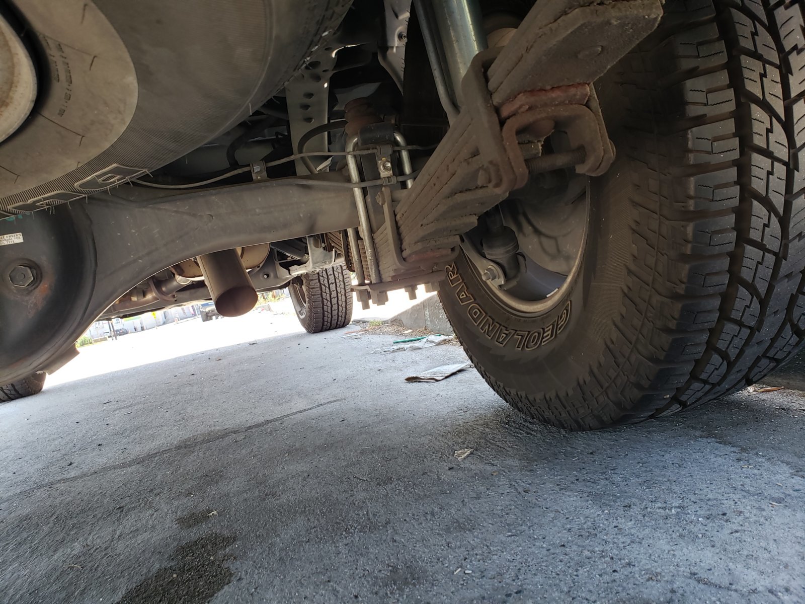

    U-boat flip kitsch have been around in the old Hilux and Taco builds for rock crawling for over 20 years. They give additional clearance on the trails and less things to get damaged. Although, the price for the kit above is steep based off those old kits. I will probably have some fabbed one day, super easy to design and build

    (2014 tundra) After clipping a rock with the stock U bolt configuration, which caused my axle to shift. I installed one of these kits along with a set of deaver leaf springs (11 leaf pack, SOA) and Total Chaos shackles. I already had the Total Chaos bump stop kit and the archive offroad flip kit top Plate Provides room for my bump stop to land. Archive offroad has great customer service and a quality product, even provided the torque spec for install.

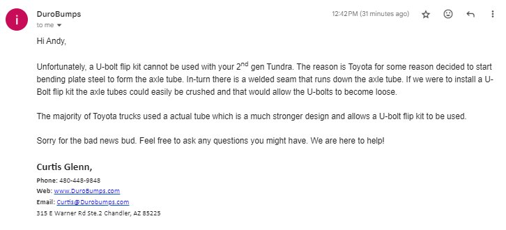

    Resurrecting this thread!
    I've got a 2020 TRD pro, and I'm looking to run airbags and cradles in the rear with a u-bolt flip. Does anyone know a u bolt flip kit that will work with cradles?
