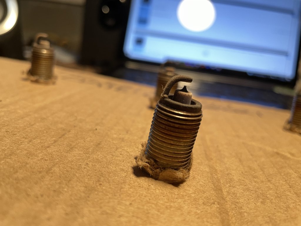

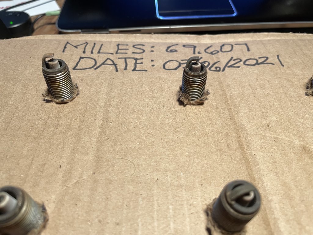

    For reference. And because we love pictures. Here are what my OEM Tundra plugs looked like at under 70,000 miles. You might say "damn near new condition."
    woods likes this.

    I think it is prudent to find out what the dealer includes in the “Tune-up”. Or, you may want to consider telling him what you want included in the tune-up. Being on the same page is important.
    At 88,000 miles most of what Mad Max mentions should be performed. I did change plugs in my Honda Ridgeline (before my Tundra) and Corolla XRS at 100,000. As TundraMcGov. Stated, I was amazed at the shape of the plugs.
    I have to ask: Is changing the plugs in a Tundra that big of a nightmare? I only have <20,000 on my 2020. So I’m a ways off from having to worry about plugs.
