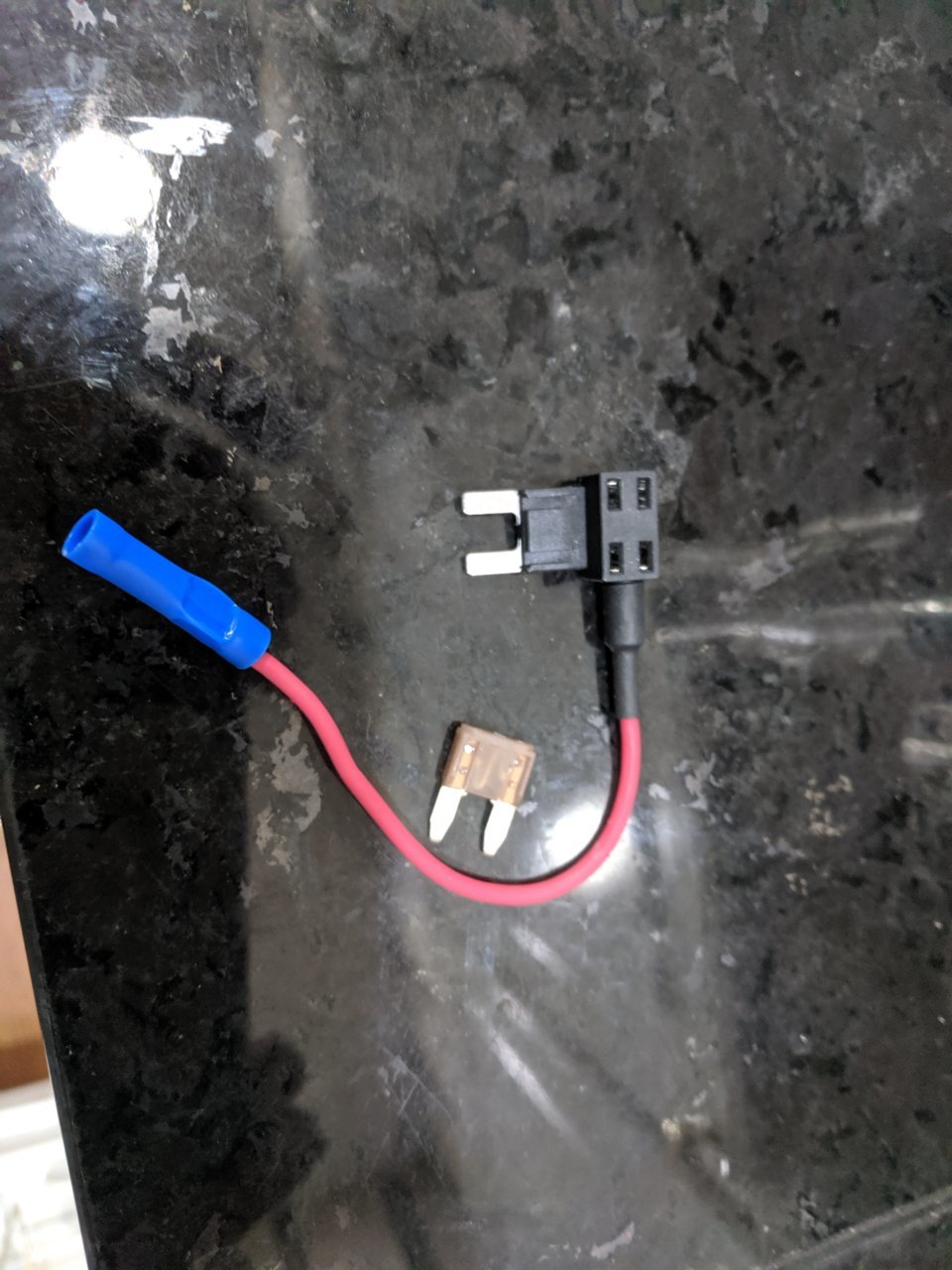

    Putting a front cam in. Not a frac. Just running one to my Tesla unit.
    Where can I grab 12 volts under the hood easily? Only want it hot when in accsy or running position. Heading to the store to get an inline fuse.
    Edit: Nevermind. Found this. Take a fuse out, put this in. Out fuse back in. You have hot wire to use.
