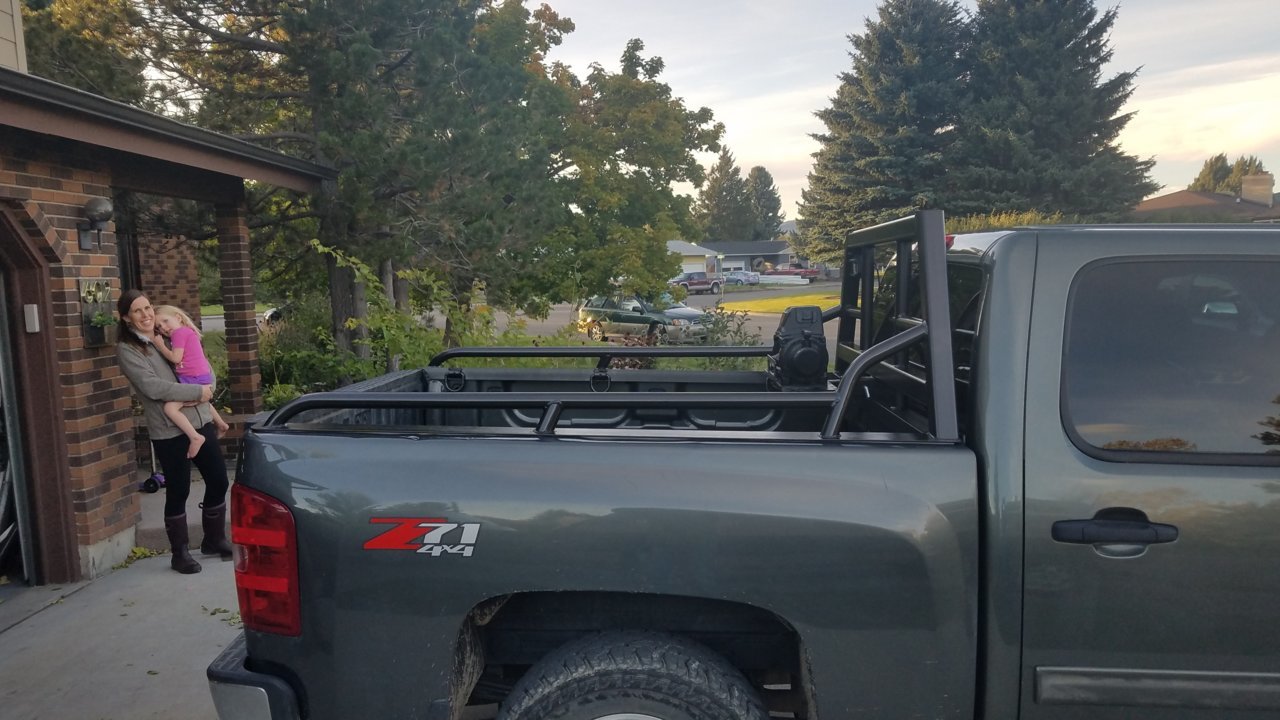

    Slightly different application but the principle is right...My dad needed less effort to load elk or wood int he back of his truck so we built a truck headache rack that incorporated a winch into the equation...here are some photos of the effort put in...it's VERY strong and usable:

    ^^Thank you sir! I did the wiring and my fabricator brother did the welding...came out pretty well! Also functions to move the winch to the rear hitch and is wired in accordingly too...best part is, it works! Ha!
