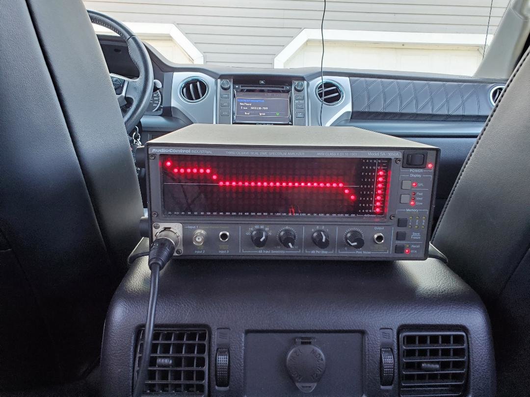

    Hi Everyone,
    I am really curious about all of your audio systems. I am wondering how many here tune their systems with an RTA and have RTA curves that you can share with the group?
    I would love to see RTA curves for everyone's install and see how well each system performs.
    I will kick it off by posting my RTA results for my system and am looking forward to seeing yours.
    Happy tuning!

    There is no curve on the DSP. Only what is analyzed when playing pink noise through the system to generate the RTA curve. Once the RTA analyzes the signal it analyzes the system output and displays the signal on the RTA's display which is utilized to tune your EQ to correct the system response.
    Initial curve looked like the shot below.
    Then adjusting the EQ in the DSP to bring the frequency response in to where it needs to be for accurate sound.
    The end result is the following EQ Curve.

    Your adjusted curve is a typical house curve. Is that a parametric EQ dsp? If so I am jealous of the number of filters you can apply. The minidsp has 6 filters per output channel plus 6 per input. So I can use broad strokes on the left and right input separately as each right and left + sub have 6 filters at the input. And then I am using one channel for each midrange, tweeter and a single sub channel. So on the output side that effectively gives me 12 filters per side plus the sub. I have a peak in the 1K range which is noticeably producing ear fatigue and a dip around 500Hz which is not responding to EQ so is likely a boundary condition due to the truck cabin dimensions.
    What kind of microphone are you using? I have the UMIK-1.
    I am planning to start all over again tomorrow with the idea of focusing my filters first on the middle of the range including that 1KHz area. It is tough as the model I am following has you tune one side to the house curve and then the other side is tuned not to the house curve but the first side tuned. (Which makes sense as matching the sides is important for soundstage and reducing harshness.) Then you play all drivers and measure and look for problems. It is this last part that is tough because I only have so many filters, it is hard to fix issues that only pop up due to interference with all drivers on.
    Have you done any acoustic material work in the cabin? You can check out my build thread, but to put it short I spent a heap of time laying down CLD, CCf, and MLV. it is a noticeable improvement but each step had diminishing returns. If I did it again, I would focus on the front doors first and foremost.
    edit: Interesting I see that you have a big peak in the 500 Hz range (nonEQd)so that puts my boundary condition idea into question. I do have that same broad peak in the 120 Hz area that only becomes apparent with both sides on. Otherwise it actually looks like a dip.

    There is a parametric eq available in the PS8, but I don't like parametric eq's. So I am using 33 bands of equalization out of 264 available bands of equalization. With the PS8 you can EQ each channel individually with its own 33 band 1/3 octave EQ. The reason that I am only using the final 1/3 octave EQ is because I typically test and tune each individual drivers enclosure and tune it to get the best performance from an individual speaker. So the 6.75" drivers are optimized in their enclosure to perform from 500hz to 5500hz, The 8" drivers enclosures are optimized to perform from 50hz to 550hz and the 12" subs are optimized to perform best in their enclosure from 16hz to 50hz. The steep Butterworth 48 db per octave crossover slope is a must to keep each speaker performing in its wheelhouse.
    Tweeters were optimized by placing them in 3 different locations and using a lot of reference music material that I have tuned competition systems with for 30+ years. Then settling on the location that provided the best front stage that was about ear level. and where the reflective properties of the vehicle created the illusion of sound beyond the confines of the trucks cab. Playing Yellow's Flag album the song The Race you can hear the car coming from about 25 feet to your left and they passing in front of you in the vehicle and disappearing about 25 feet to your right of the drivers seat.
    There is quite a bit of acoustic treatment in the cab of my truck. Its all Dynamat. The front door panels are fully covered on the back side and the front doors themselves are treated in areas where they resonated.
    I dont have any dynamat in the rear doors as they dont have any drivers that are active in them and they dont resonate with the system the way it is set up.
    The nice thing about the ARC Audio PS8 is you can shut off each driver in the setup. That way you can tune and level each driver individually. So if you run in to acoustic problems you can isolate them and correct them very quickly.

    Dude! Come over and help me tune my truck. That dsp is awesome sounding. I tried EQ each driver individually but I didnt get great results but I am very new at this. Of course, I am regretting a little not going with a dsp with more tuning filters per channel but c'est la vie.
    Tell me more: tips specific to trucks, working with a 2 way plus sub system etc.
    edit: and pics...lots of pics like the tweet location etc.
    I am running stereo integrity m25 tweeters and rockford fosgate (not very good but hey) 6.5s in the stock locations. Two alpine 8 inch subs in a q logic box that takes the place of the rear underseat compartment. 70 W to each driver and 500 W to the subs wired in parallel. Added a protective capacitor to the tweet and ran new speaker wire to every driver.

    Thats exactly what I wanted to see...what the adjustments you had to do inorder to get the ultimate curve you have.
    Did you listen to your system with a flat curve before you decided to shoot for the curve you have?

    Yes, I adjusted the system based on how it performed from the flat curve.

    I havent used an rta to tune yet mainly because my eq is limited, but i gotta say, your rta curve is pretty much on point. Must sound damn good.
    You also used a real rta, damn man. Lol.
    If and when i decide to tune my system properly im going to use either the minidsp calibrated mic or the parts express calibrated mic. The minidsp one is quite a bit more expensive but it works with rta wizard on pc.

    Start by setting your EQ flat all the way across the frequency band. Using pink noise the best thing to do is set all of your speaker levels for the drivers ears, so place the mic in the location of your left ear, then set the volume to 76 to 80 db with the left tweeter note exactly the DB you set it at. Then set it at the exact same level for the mid on the left. Then the sub on the left. get them all perfectly balanced on the left, then do the right channel tweeter, set it at the right drivers ear at the same level you set the left at. Then the right mid to the right ear at the exact same level, then your sub at the right ear and the exact same level. Once you have done that you should have a perfectly balanced system and you can begin to tune.
    Now look at your RTA frequency response to determine how far out each speaker is. Start with your tweeters and mids first these you will want to use my curve as your goal.
    The bass (Subs) you will adjust last because they will be the hardest to get right. A lot of people over power them and they sound muddy and distorted. You want them to sound natural. you will want to boost them 4 to 6 DB above what your mids are at. It will give you a nice natural sound. If you have a well tuned system you will start to find fault with recordings. You will know how a CD was recorded or how bad a MP3 file truly is. The system should be able to play any type of music accurately without adjusting anything when you change between Rap, Classical, Jazz, Electronic, Dance, Big Band etc... A good system will play them all accurately. Accuracy is the key.
    Anyone can make a system loud, very few people are able to tune a system that reveals flaws in recording methods and really shows off well recorded music.
    The other thing you will notice if you set it up correctly is that you will keep lowering the level of the volume as it will sound really loud over time without you realizing how high the levels really are.

    No audiofrog. Just bought the Umik with a minidsp.
    The curve was constructed by audiofrog and you can download it from their site to import into REW as a starting target. I will likely attenuate my final target curve somewhat from this one on the upper end and bring up the midbass a bit.

    I think that the curve you have posted is pretty interesting. There is a 20 DB swing between the bass level and the treble rolling off at the upper end. That is a lot of dynamic difference. Hopefully you will be able to reign that in once you start tuning.

    I know that seems like a lot. I definitely like a bass heavy sound and just messing around without measuring, I often end up attenuating the upper end further but I think this is due to sibilance. Many curves that people are using swing somewhere in the 15 dB range. (JBl, Crutchfield, etc.) I havent had time to tune lately but my biggest issue is still something in the treble end. The sibilance is better but I think I can reduce it further. My next attempt will use the HU EQ to tame things first and then use the dsp filters modestly. Meaning I am going to refrain from trying to get dead on that target curve and rather leave some filters available so that once i listen to some music, I can fine tune. It is really tricky business!
    I also take in your comment that any genre music should sound good with a proper tune, assuming a good recording. Boy, I am far away in this regard. Electronic music seems to always sound the best, I guess it is the nature of the recording, but classic rock is really missing a lot in my system. I want to blame the weakest component which are the 6.5 rockford drivers but I do think that I can still get them to sound a lot better with a better tune.
    I just keep reading and trying!
