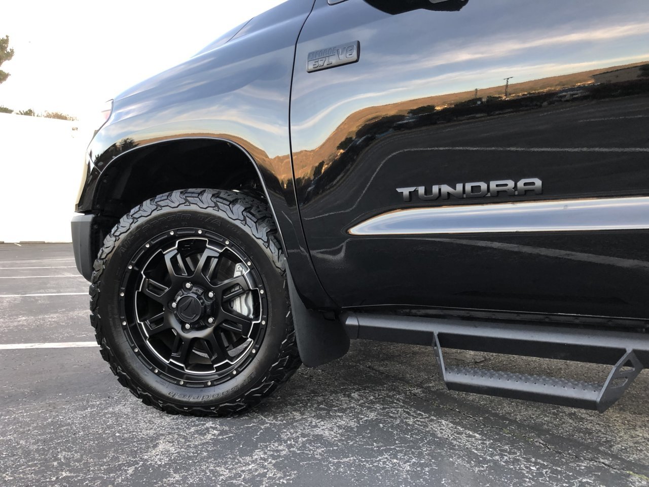

    I have this style... +50mm offset
    Akaklutz, TundraXPLover and GNTundra like this.

    80
    Alan
    2021 Tundra
    New stock
    This picture mad me decide to pick up a set of these wheels. What tire and size are you running? Look great btw
  19. Feb 14, 2022 at 12:20 PM
    MER
    MER New Member
    Nov 17, 2018
    #21827
    70
    18' Limited CM 4x4 Off Road
    Thanks. These were BFG KO2’s in an LT285/55/20.
