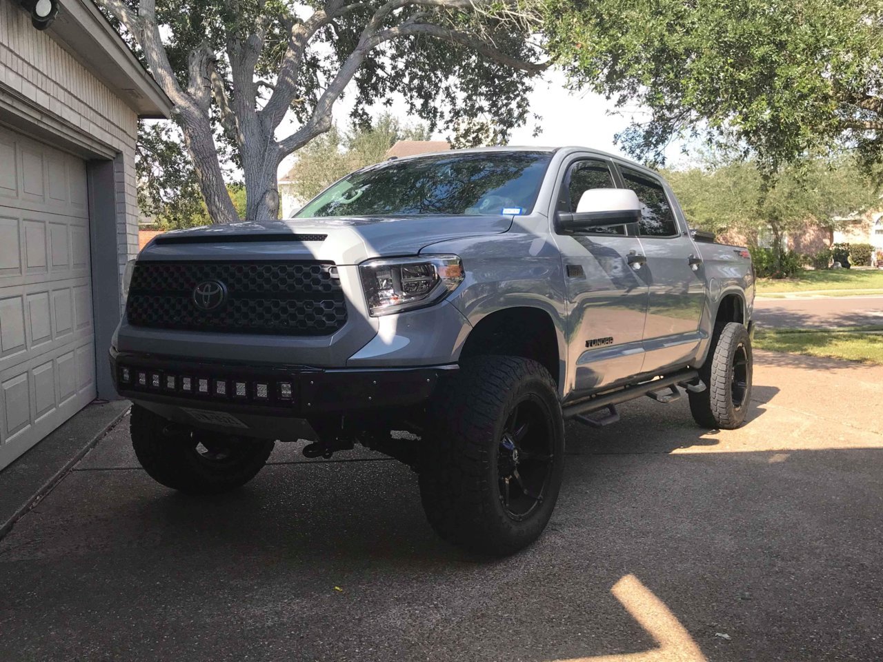

    Radflo @ToyTec Lifts Complete Performance 3" Lift Kit
    35” toyo at2s
    snowman19, ARES, geno0506 and 3 others like this.

    That looks nice. Thanks for the picture

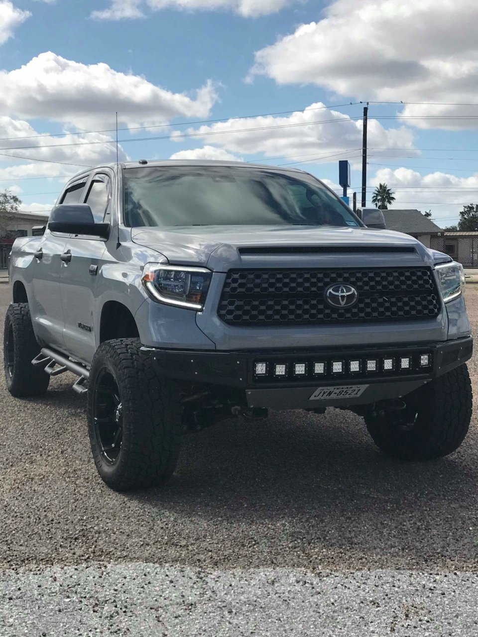

    As stated previously we do recommend keeping rake on the truck to insure proper operation of the sensors, you can still get a nice aggressive stance and lift the Tundra, but in the same sense we need to keep some rake on there.
    The truck that Sean posted has the adjustable 1.5'' rear shackles in the rear end on there.

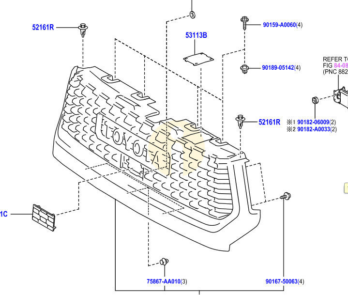

    I agree with keeping some rake, mine has no issues. That said mine has been at different heights with negative rake and no lights. If you look at the next pro grille, the sensor is lowered, actually below the Toyota script. Maybe it is lower due to the script, or maybe to accommodate the lift?
    Got this image from the 18 parts thread, sensor part #is cut off, 1C in the bottom left corner.
    Tundra9831 and midnight[OP] like this.

    Its to offset the the 2" lift of the trd pro suspension. The TRD suspension per toyota is not compatible with 2018's which can only be because it raises the front end because no part of the suspension was changed from 17 to 18. This grill will make it compatible again but if you don't level your truck and use this your sensor will be a couple of inches low now. I have the pro suspension installed in my 18 and the safety stuff works without an issue from what i have seen

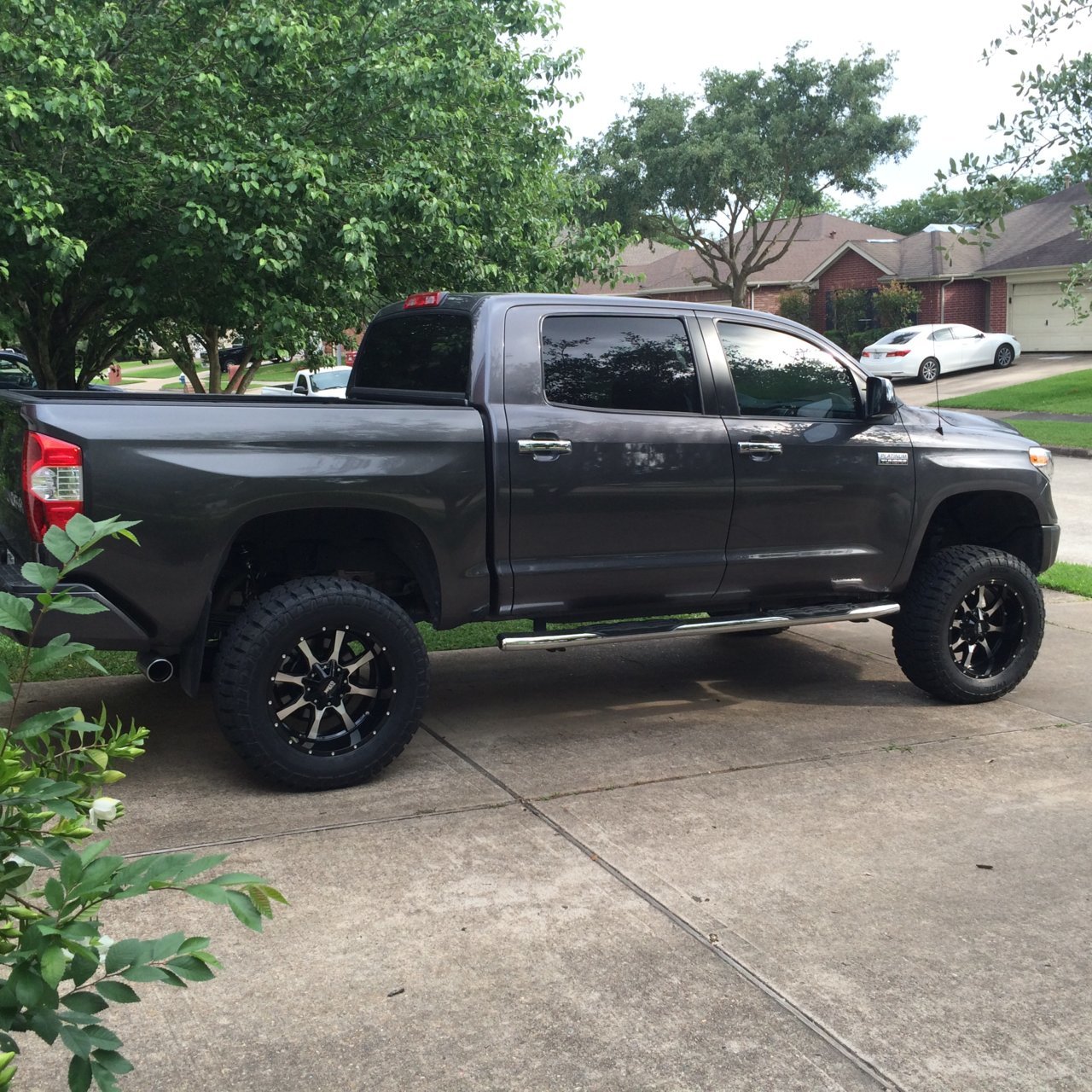

    My 2018 Platinum has a Pro Comp 6" lift. Originally, the lift had crazy coilover spacers that gave my truck a "reverse" rake as the front sat 3/4" higher, than the rear. No problems with TSS. Than, switched to RC 6" coilovers which reversed the rake so the front sits about a half inch lower than the rear. Still, no problems with the TSS.
    With reverse rake:
    With 1/2" lower front rake:

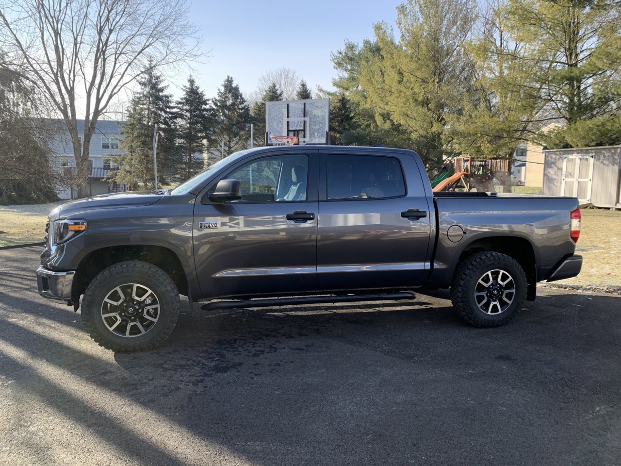

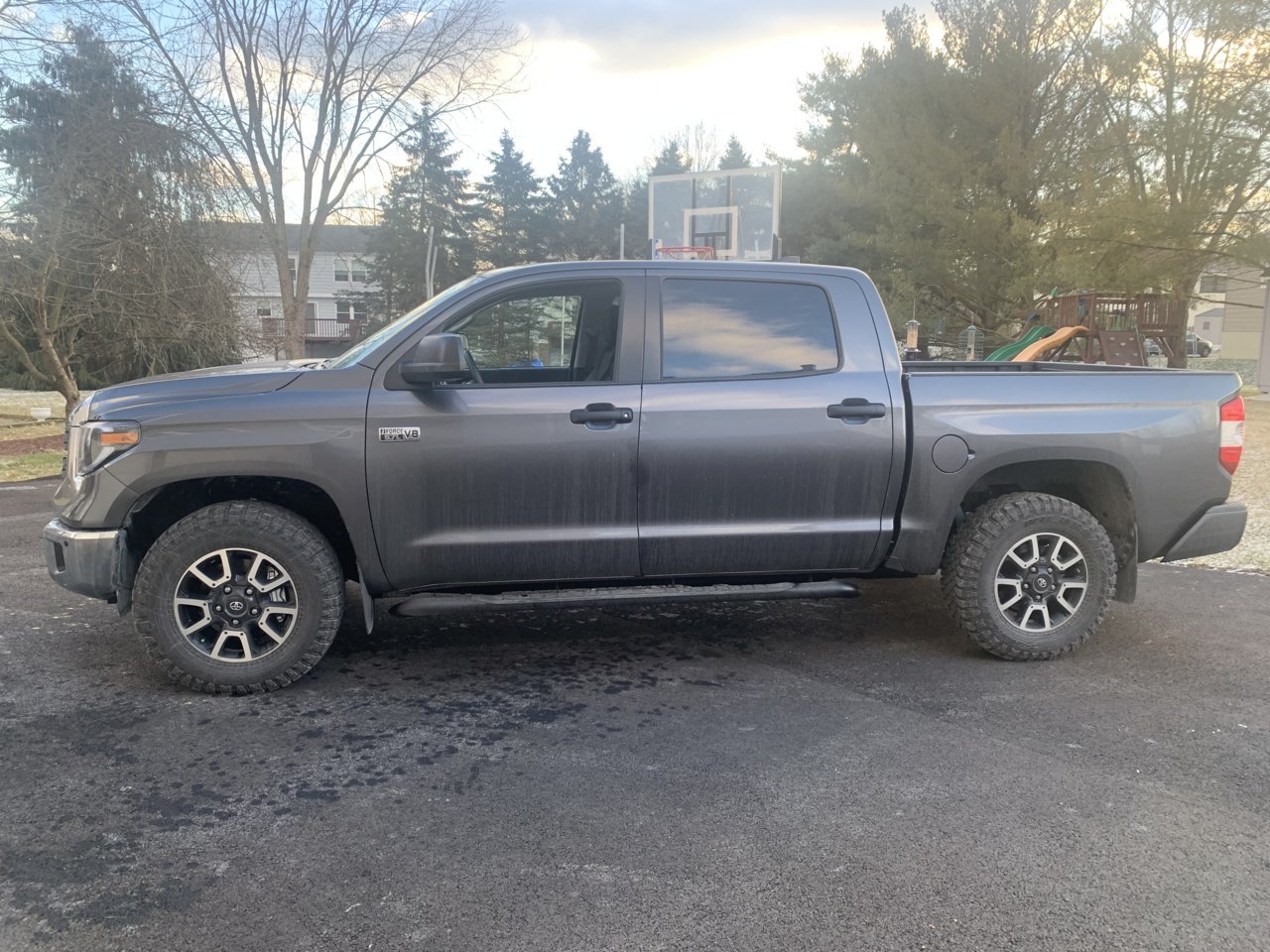

    CA51B2E2-DBB2-4254-A103-BE9C4B5A4A3B.jpg 39AF7CEF-B6FF-487C-9CBB-BA120ED4AA92.jpg Bilstein are on. No lights. Life is good. :cheers:
    Top pic- before
    Bottom pic- after
    .....also washed it
