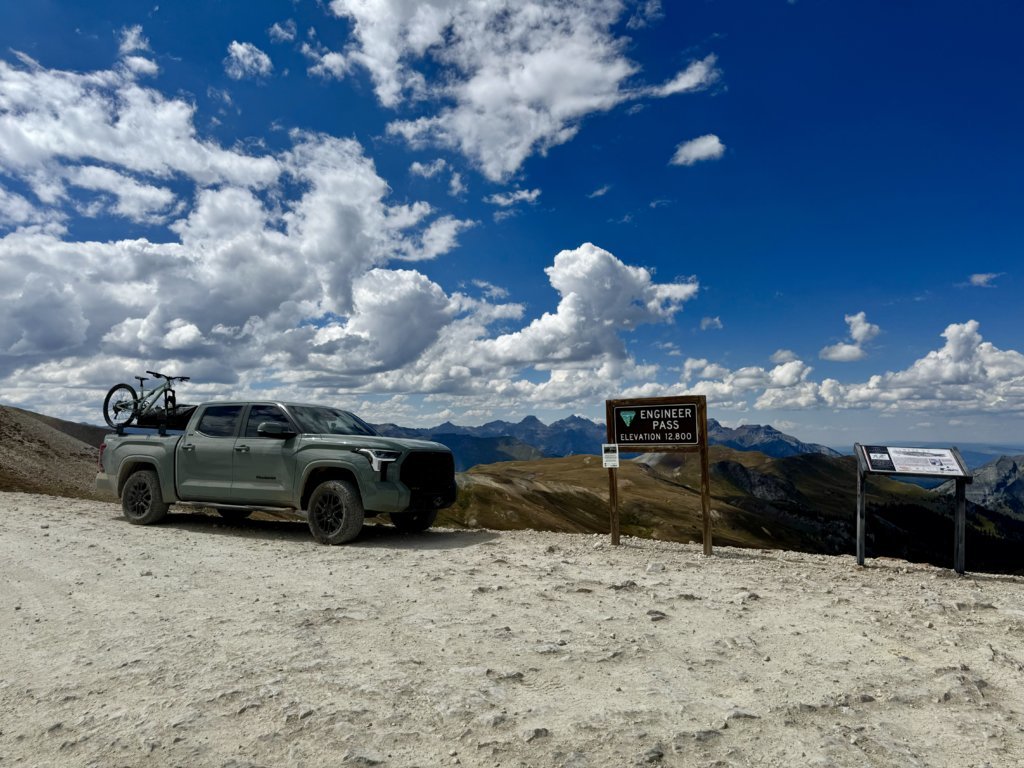

    I put the same lift on my 24 TRD sport. Everything bolted right up. The only thing I found from my research is it’s recommended to use red axles. Mine still has the black axles and I recently wheeled it in Colorado for a week and had no issues.
    I’ll probably install red axles at some point but for now it’s working good.
