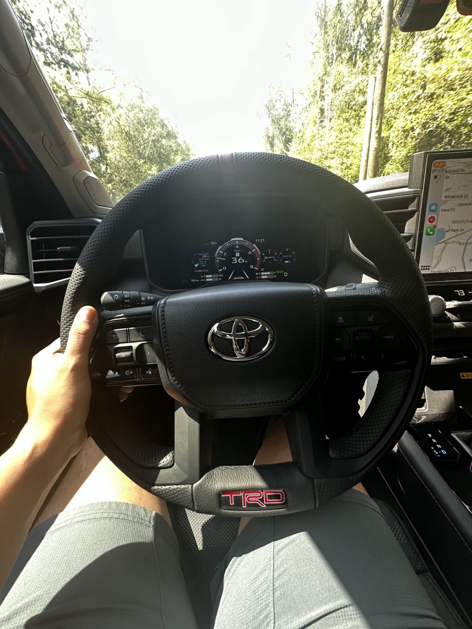

    Hey Folks, I've researched the forums and couldn't find exactly the answer I am looking for. I installed 35X12.5X18 Kenda Klever RTs on my 23 TRD PRO and for some reason, the steering wheel is off-center now... The car isn't pulling per se but any idea what could be causing this alignment issue?

    Yes, steering wheel.

    There is no shake - so I would doubt the lug torque is an issue. Just the steering wheel is off-center. Sounds like I need an alignment but I am curious if something else could be the culprit.

    Maybe the tire hit the sway bar at full lock or travel of shock. How much is it off by? 1 degree or like 1-2 o clock position

    Slightly off.

    Swap front tires to other side and report back.

    Switched the front tires and fixed the issue. Looks like a tire defect! Thanks @ZPhilip !!

    IF it were me and the truck was not pulling and when they swap the tires it corrects the issue.
    I would want at very minimum those 2 tires replaced.
    It could be a weak or a month and you have the same issue or a new one.
    I am suspicious because anything that is tire related that would cause off center would also cause it to pull.
    I wonder if they found something they did and corrected it without saying anything.
