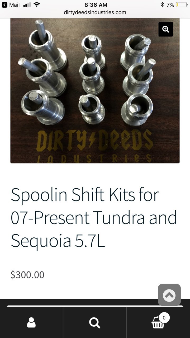

    I have the AB60E /ab60F transmission , have been cruising here and TT for info and found that most people change the silenoids in question and have had success. Can anyone tell me if shift silenoid D is: part #35240-50050
    And shift silenoid c is transmaxx 147423B?

    Since you guys seem to know and some of you have done these builds,would they’re be anything that you would insist to get used for the build? I was looking at the spooling shift kit sold on Dd, the trans mentioned fitting higher quality and more gears into it and machining out the trans and valve body, but w/o the real knowledge about transmission I was semi lost (my wrenching was mainly on 350’s/302’s strapped to a boats). I would love to switch out to a auburn air locker & lose the fake LSD while I’m at it but I just ain’t ready for the bill that comes with that. But if they’re is trans related upgrade id really like to make this upgrade count. Also I’m running 35” muds if that plays any part in ur answer. Also I rarely towupload_2018-12-8_8-38-5.jpg
