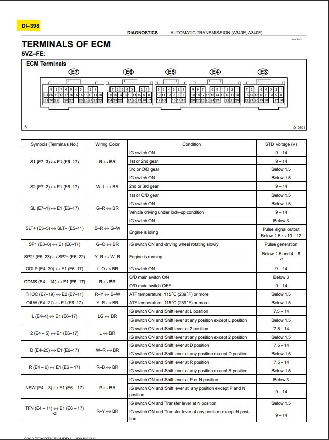

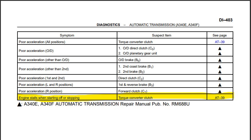

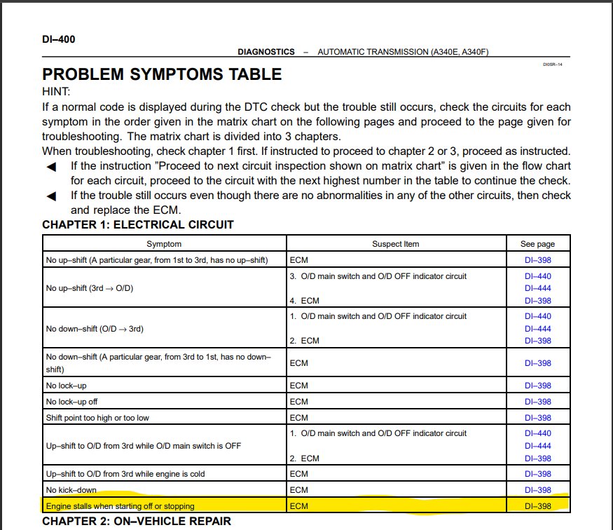

    Here are a few examples I've dug up real quick based on your information
    EDIT: For future searches, the FSM sections are alphabetized. So AT-xxx will be long before DI-xxx when reading and searching.
