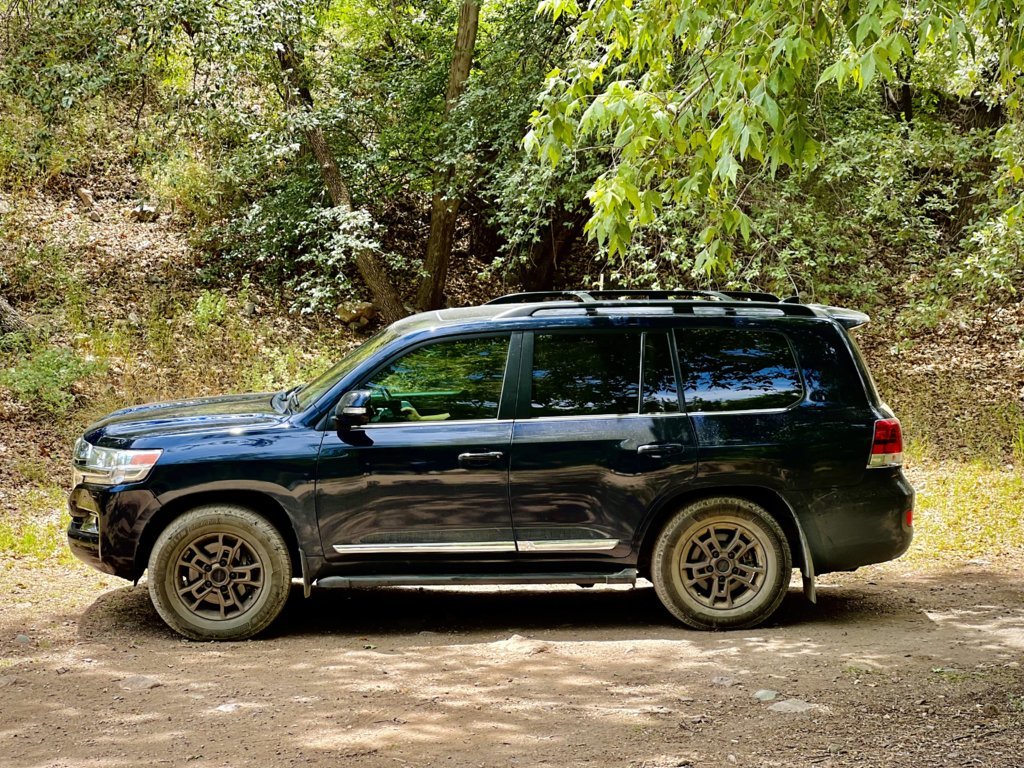

    Thank you all for the info. Will try 4L next time, it may allow less surging back and forth as you go uphill and modulate speeds. As previous threads, some small things are still a bit of a disappointment, but small turbo engines in big vehicles, are not ideal for crawling around like that. Overall the truck is smooth on the road, and no issue since. Going to steal the 200 LandCrucher :) from the wife next time.

    Smart man.

    There is no substitute .......nice rig
