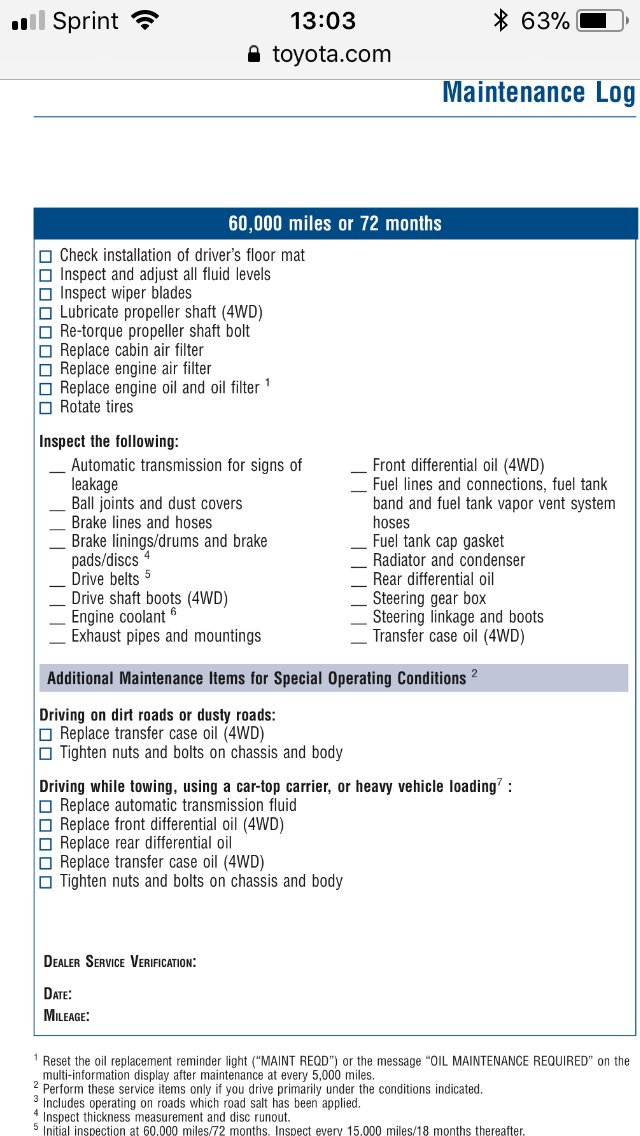

    Look in your manual that came with the truck. It specifies what needs to be done and when.
    They list a transmission fluid change at 60k miles for vehicles that tow. That’s when I plan on having mine done at the dealer.
    Edit: this is from the 2015 maintenance log. Should be the same for all second and third gens.
