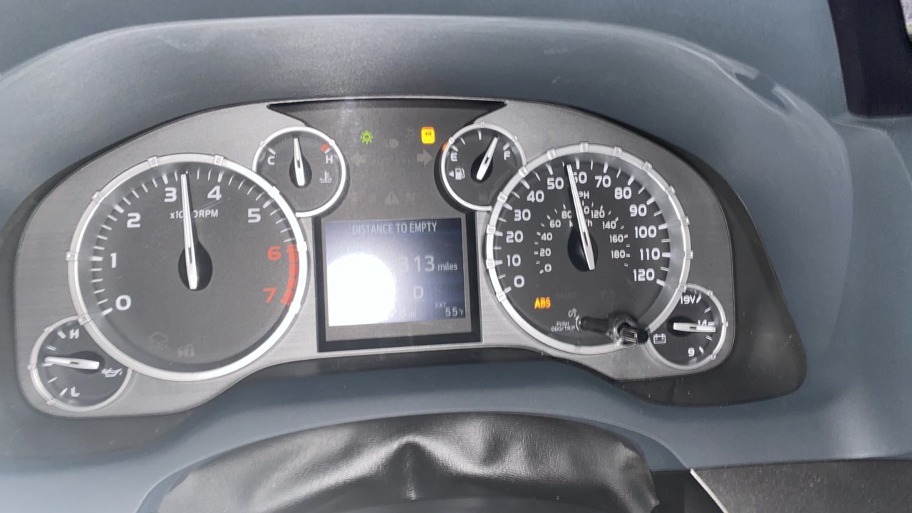

    I was heading to work and all the sudden the traction light and abs light lit up. When I would accelerate the rpm would shoot all the way up. I thought it was going to die, but I was able to exit the freeway and made it to the dealer.
    Has anyone had this issues and what cause could be.
    I did a search and could not find an answer.
    Any advise would be greatly appreciate.TIA.

    May have you some rodent damage to the wire harness.

    Mileage? You may have a worn wheel bearing which can cause the tone ring and abs sensor to misalign or even destroy the sensor tip because the tone ring chews on it during rotation. Basically there is little clearance between the tone ring and sensor tip, then when the bearing goes the sensor tip gets into the tone ring on some vehicles. Not exactly sure on the Tundra though never had mine apart yet.

    I had this similar problem before on my previous truck. same symptoms. mine turned out to be a bad sensor. replaced the speed sensor and life is good.

    Maybe an issue with the wheel speed sensor. They can cause a lot of things to go wrong. This past winter, mine got gummed up with wet snow and caused my abs and traction control lights to come on and wouldn't allow me to shift in and out of 4wd until it got cleared out.

    Damn , I should have checked those also, I have sdhq covers on all of my sensors, i figure they would be ok.

    I just got a call from the dealership, he said that technician found nothing wrong and the only the that he said was i have aftermarket stuff that is connected to my stop lamp circuit and I said what it that and he said that I have stuff connected to my brake lights, and I told him all i have is a led light and that was throwing the sign and he said yes, that’s all the code he was getting. That’s kinda hard to believe since I got those Led light bulb when I got my truck 4 yrs ago. So all they did was just reset the code. I guess I will pick it up and wipe down all my sensors.
    Regarding the sensors, do i just wipe it down with water and towel or is there any other methods so I dont jack it up.
    And if it happens again , just take it back.

    I would unbolt them and carefully remove them by carefully pulling them out of their home. Then clean with a rag or old toothbrush and mild degreaser like simple green or dishsoap and water. Then reinstall. Emphasis on carefully, dont want to break the plastic! You may be able to just go to the car wash or use a pressure washer also. Place a jack under one corner at a time and spray all around inside wheel front and back to clean out the tone rings and the sensors. As you spray rotate the wheels to clean all around the brake parts really well to remove any and all foreign debris and brakedust buildup on the tone rings. Pretty sure the back tone rings are part of the bearings and sealed up. So you can really only clean the fronts as described at the car wash.

    Make sure they actually use a scanner that reads ABS. most of our autozones here in my area just uses a generic scanner so i just bought my own, DTC, ABS, and airbag codes scanner
