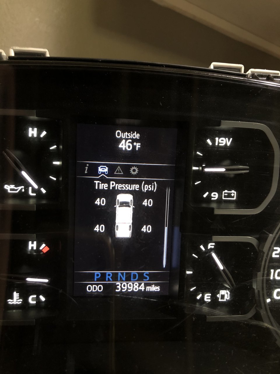

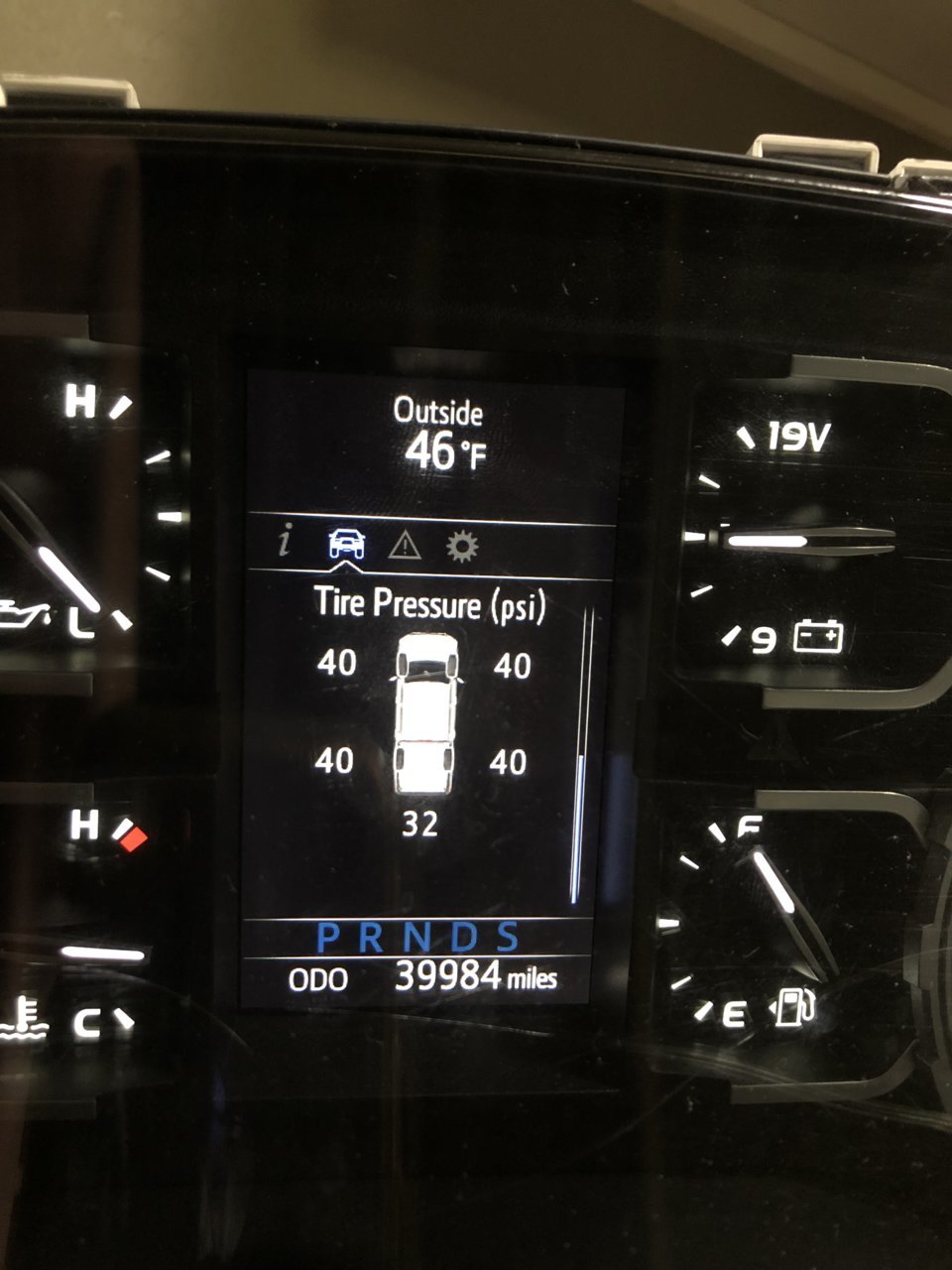

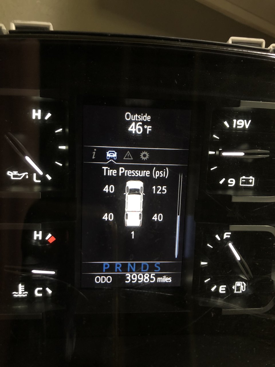

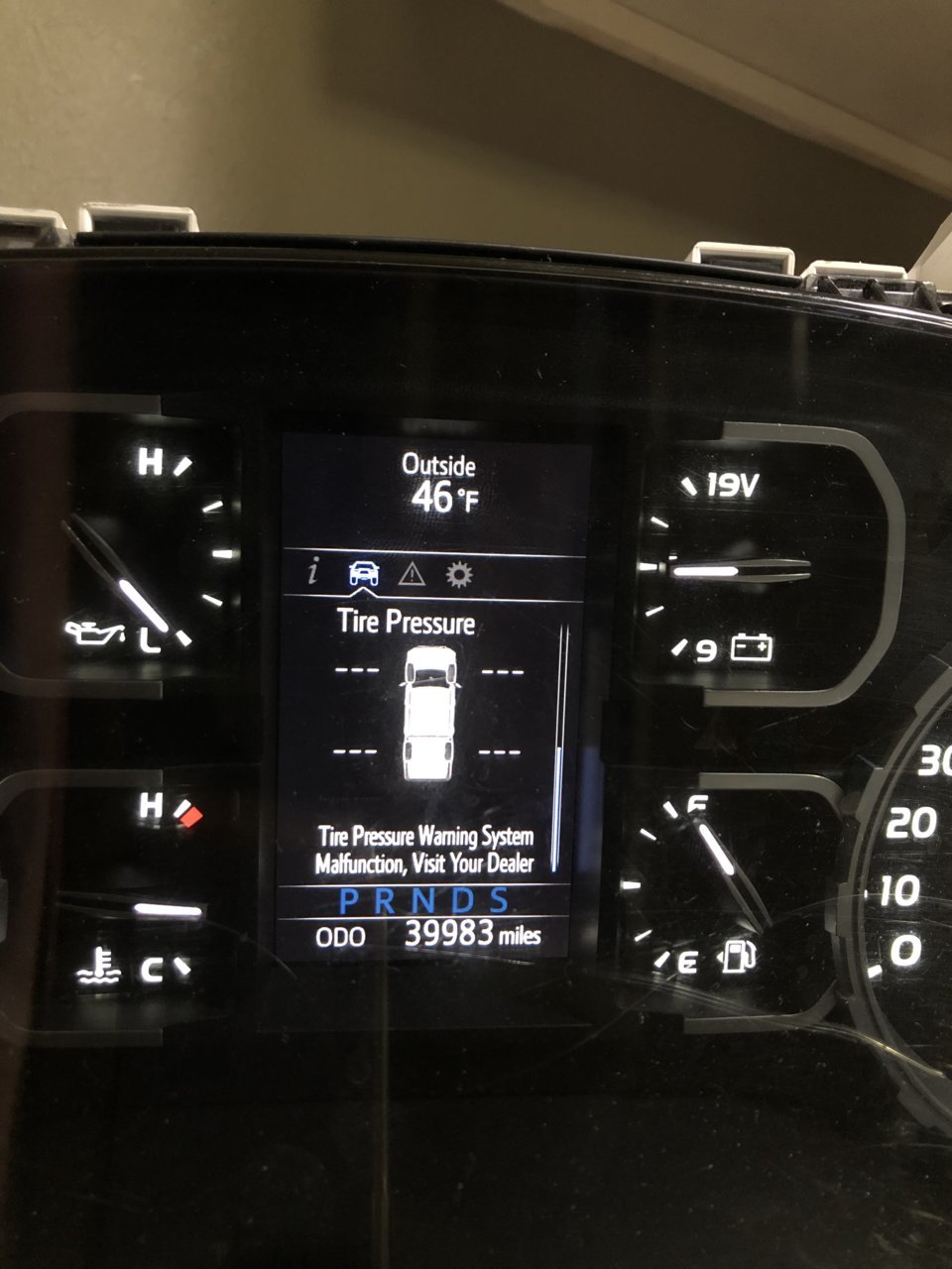

    I have a 2016 that came with the trd off road wheels...does the small spare from the factory not have a tpms sensor? I am adding a full size method /wildpeak to match the rest of the truck
  26. Jul 14, 2022 at 3:53 AM
    #26
    Jeff_5_7
    Jeff_5_7 New Member
    Feb 20, 2021
    #59378
    1,439
    Jeff
    Houston Tx Area
    2007 RCSB 2014+ TRD Pro Conversion 5.7 4x4
    Full 2014+ Conversion Regular Cab Short Bed 4X4 2019 TRD Pro Grill, 2014+ Front End Swap 2014+ Interior/Dash Swap with TRD Pro Leather Seats, 2014+ Bed Swap with TRD Pro Stamping SOS 2/4 Drop Kit
    Just stumbled on this thread.
    In doing a bunch of work mapping signals to the 2018+ cluster, I found it has the ability to display 5 tire pressures on screen with a value from 1-125 PSI. Getting the 2018+ TPMS ecu programmed to display the 5th and values over 50 PSI is another story. I don’t think Techstream allows you to open up these options but the cluster can handle and display this info if the TPMS Ecu is sending it.
    This was done with a 2018 cluster running on the bench where I replicated and modified the signals that come from the TPMS from my laptop. I do actually have a TPMS ecu laying around, bought one shortly after this but never really dove into it to see how it works.
    AB8DCA2C-9B9E-427B-A382-648707E748B3.jpg A853A2C2-52D4-44F5-B516-B3A3AE3532F8.jpg 8F4F428F-A48B-4B49-8F29-5E42F96CDFA8.jpg EC3EE4AE-FEC2-41E3-B62C-F12C7C0C8A81.jpg 9A2DCD82-90E5-4EA0-869D-8F46BA377B02.jpg
