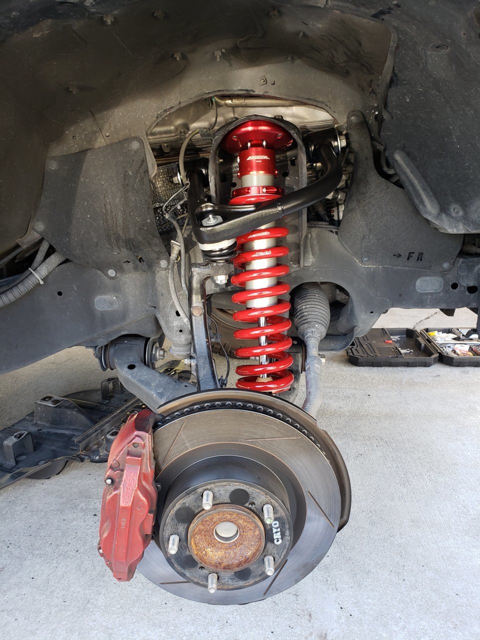

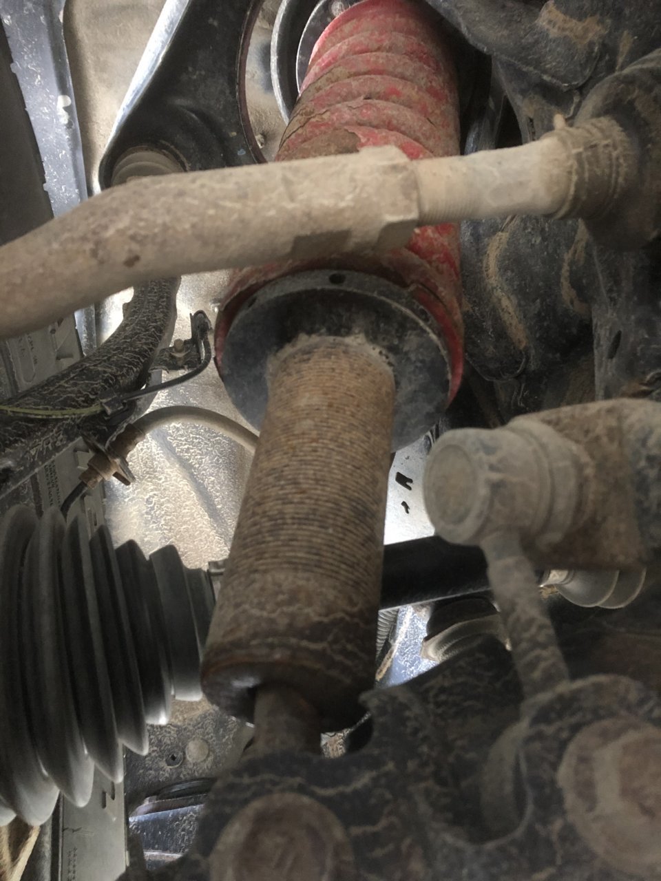

    46FF27B4-56C9-4CD2-8FA3-1FEECC362147.jpg My 2015 Tundra is a glorified minivan, but then this happened.
    I had a catastrophic structural failure of the Toytec Boss front passenger side coil over. The shaft has appeared to have broken its weld and puncture its way into the coil over assembly, thus dropping the truck almost 2” on the front passenger side. Noticed the truck sitting wonky on the driveway, didn’t notice an on road impact (as it’s just a grocery getter). I do live in a salty climate but this still should never have happened. I’ve been in contact with Toytec and I do hope they won’t leave me high and dry, but we’ll see as there is more time on these then their warranty covers, an no hard feelings if not.
    I love their product, this Boss kit made the truck ride better then stock and now with a front failure I need to replace the front end and might as well upgrade the whole kit to the Aluma 2.0 series. Again I’m not taking this off-road so I don’t believe the 2.5 is justified but the 2.0 should still be a direct upgradable difference to this older Boss kit. I still have factory upper control arms, so I wasn’t planning on changing those with a direct 3” kit swap and the truck handles fine on the road (maybe not being able to compare it to something with UCA swap) but I just hope I’m going in the right direction staying with Toytec and moving to the Aluma 2.0 Coil overs front and aluma rears.
    What’s your thoughts?

    Holy shit! Salty? Like...you live ON Salt lake or what! Your driver side looks crispy too! Keep us updated with word from ToyTec..

    Alberta roads are definitely salty in the winter but I’m a stickler for the wand wash. The only gravel this sees is the 1km from the hi-way into our yard.

    Have you been spraying your truck with anything to protect it from the salt? It not, this is likely to happen again.

    Truck has a under coat protection from Dealer when new, but I wash regular and more so in winter. Picture was pre wash and post muddy gravel roads into the yard off the highway.

    That is alot of rust man. It must have penetrated though the weld over time and caused the failure. Add a metal protectant on it and clean them often to help prevent that kinda rust.

    The undercoating is not on the suspension you added later right? I would soak everything in WoolWax or similar each fall before the salt sets in.

    No nothing on the suspension components so that’s a good point. But that was a major push to go to the Aluma series to help with our norther climates here.

    They were installed right at the dealer in 2015 and about 100k km or 60k miles ago.
    After seeing what my Ultimate kit looked like over time on my Tacoma I spent more money at the car wash over their life that’s for sure, especially during winter. Still don’t think a catastrophic structural failure was warranted though.

    I would suggest using fluid film on every single bit of metal on your underbody and suspension. That's an insane amount of corrosion. I live in the salt belt and the previous owner of my tundra and myself religiously use fluid film and theres almost no rust after 120k miles.

    Thanks will do. A lots of what you see gravel road spray as it was after the rain but I go agree these coil overs have not liked the Canadian climate
