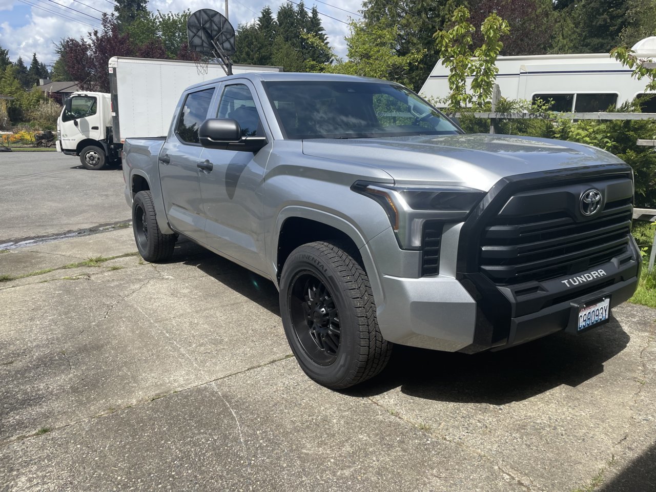

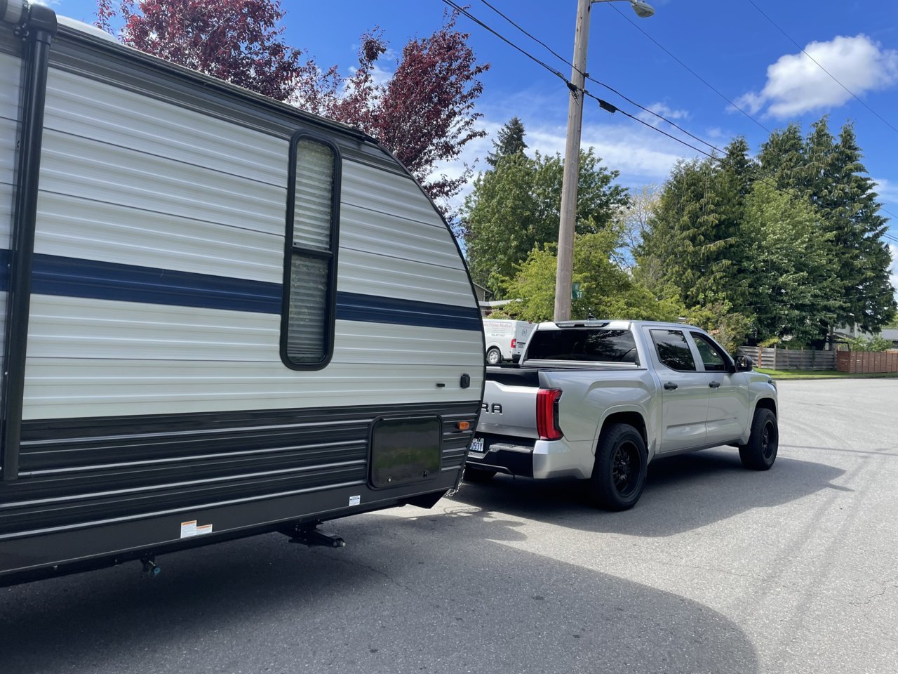

    sorry, don't have better pic when I was towing

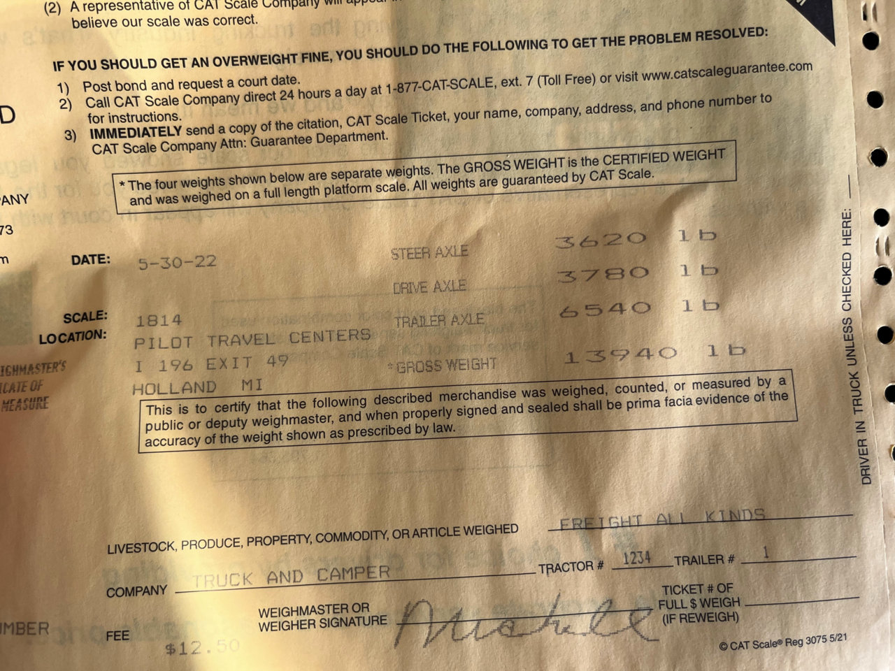

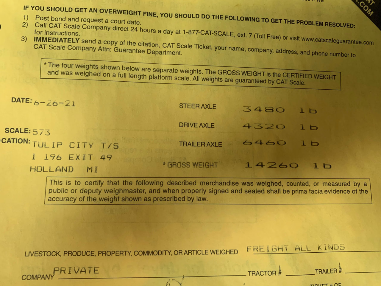

    I had bags on my 2015 and removed them. The truck rode like crap empty.
    They don't add much weight but they do put your rear axle weight right over the top.
    IMO, not a good solution.
    I put a set of Sumosprings and that was a better solution in that the ride was WAY better empty. But I still had the problem with weight on the rear axle. Here are two weight slips. Same camper, same WDH. One was my 2015 with Sumosprings and the other is my 2021 Pro without. I did dial my WDH in for the Pro.
    Things to note:
    1. The truck without Sumosprings had more front axle weight - A good thing
    2. The truck with Sumosprings was overloaded on the rear axle. It was not allowing the WDH to do its job.
    The Pro does squat with the camper but the ride and axle weights are worth the squat... IMO
    I have a set of AirLift bags for a 2.5 gen that I will sell for $25 plus shipping if someone is interested. All hardware included.F224075A-590C-419F-816B-9B78314AFA2A_1_201_a.jpg5E2D2F28-CC12-4276-B748-F74ED56449D0_1_201_a.jpg

    Very nice! I have to say that SR looks a lot better than a lot of the SR5 and Limited combos I've seen. I'm also with you on it not being worth another $20k-$30k for the higher trims in today's market--no thanks!

    @mverkaik
    On those 2 weight slips, did you readjust the wdh after putting the sumos on? There is a 300lb difference between them so its hard to compare, but the ratios I understand are way off. The sumos would unload the wdh bars a ton, so I’m curious if you reset the hitch at all to accommodate for that?
    i tow my smaller trailer with sumos and they are awesome. They really help with weight in the bed so you don’t bottom out all day. I usually run 5-600 lbs of camp gear when hitched up, the wdh isn’t helping with that load

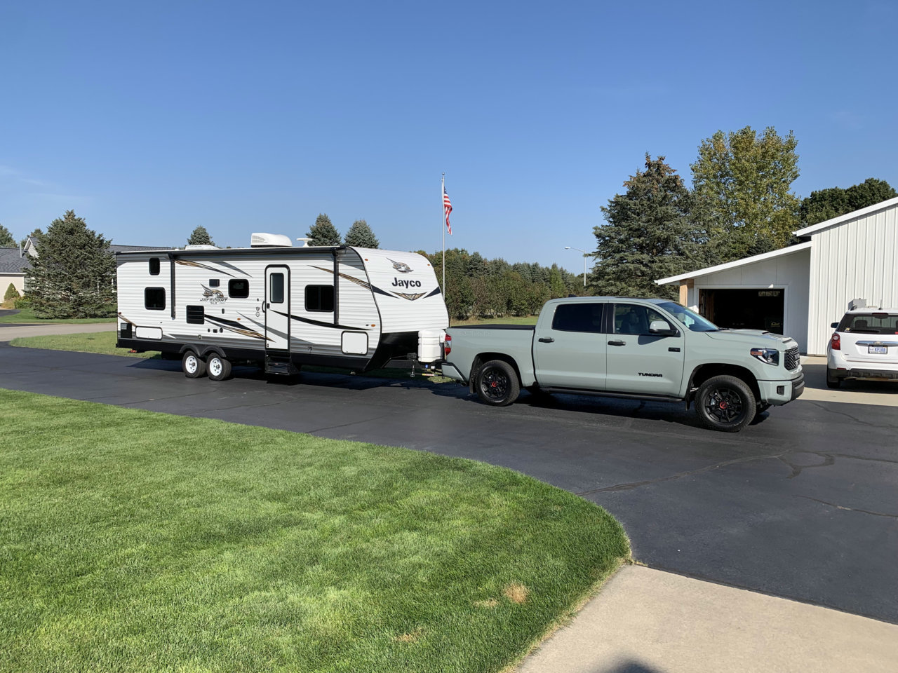

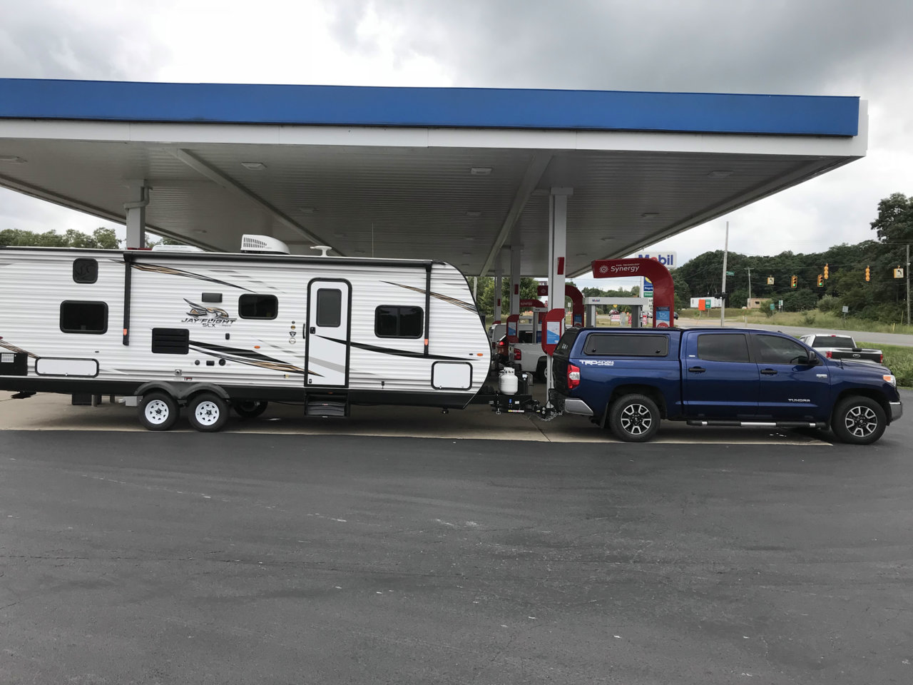

    If your bags are installed attached the the frame and the axle like most kits do they will never be disengaged..... even at 0psi. As soon as the axle travels up they pressurize giving you an effectively stiffer spring, then when you axle goes to droop you get negative pressure in the bag and they limit your down travel. This really shows up when you are driving over a railroad track or an undulating road. Night and day ride difference with them removed.
    They have a similar problem when in use. The pressure changes as the suspension travels effectively limiting your travel and killing the ride quality.
    Some are fine with this and they love their bags. Some put Daystar cradles on them and this helps with some of the problem.
    I found that a progressive bump stop like the Sumospring actually worked much better for me. It did fix the squat look but it did not fix the overloaded rear axle.
    Remember that if you are eliminating squat with bags or some other helper you are reducing the effect that the WDH is having on moving weight off the rear axle to the front. Unless you are really loading up your bars prior.... But then you probably won't need the bags because you have moved all the weight off the axle.....
    Function has to follow form when you are towing if you want to be safe. Here are pictures of the two trucks pulling the same camper. The Pro is about 1.5" lower in the rear than the 2015 was. The Pro looks more pronounced because it sits level from the start whereas the 2015 had about 2" of rake. That and the front suspension one the Pro moves more than the 2015 with weight transfer. It is softer and helps with the ride.

    I don't get it either!? .. yes, lifting the back would not add weight to the front axle - people often misunderstand that part , but stiffer springs not allowing WD to work well?? .. that is news to me

    totally. You have to re measure and adjust the wdh after installing any spring helper. Otherwise you’re wasting your time. You raise up the back of the truck to get the bars on, so of course adding bags or sumos are gonna have the same effect unloading the bars. One could easily add more tension to the bars after the helper springs to reset the weight back to the front

    I tried. It is hard because or the amount of bar that needs to be applied to keep the truck off the Sumosprings. If you dial in that much bar you won't have squat without the Sumosprings. Things behave very oddly with that much bar dialed in. Keep in mind that I only have about 2.5" of suspension deflection without the Sumosprings.
    Have you weighed your rig? It is eye opening.
    Edit: I purchased that camper and WDH after having the Sumosprings installed. The setup in the picture at the gas pump was after the dealer installed the new hitch on the new trailer. I played around with the adjustment on it after. I readjusted for the Pro after I got it.
    I always use the front wheels as my guide as to how much bar I dial in. The front axle should not gain height when loaded.
