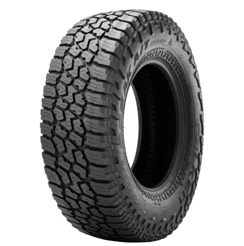

    Nitto terra grappler comes LT And P295
    I’m gonna pull my Wildpeaks off and sell...they only have 200 miles
