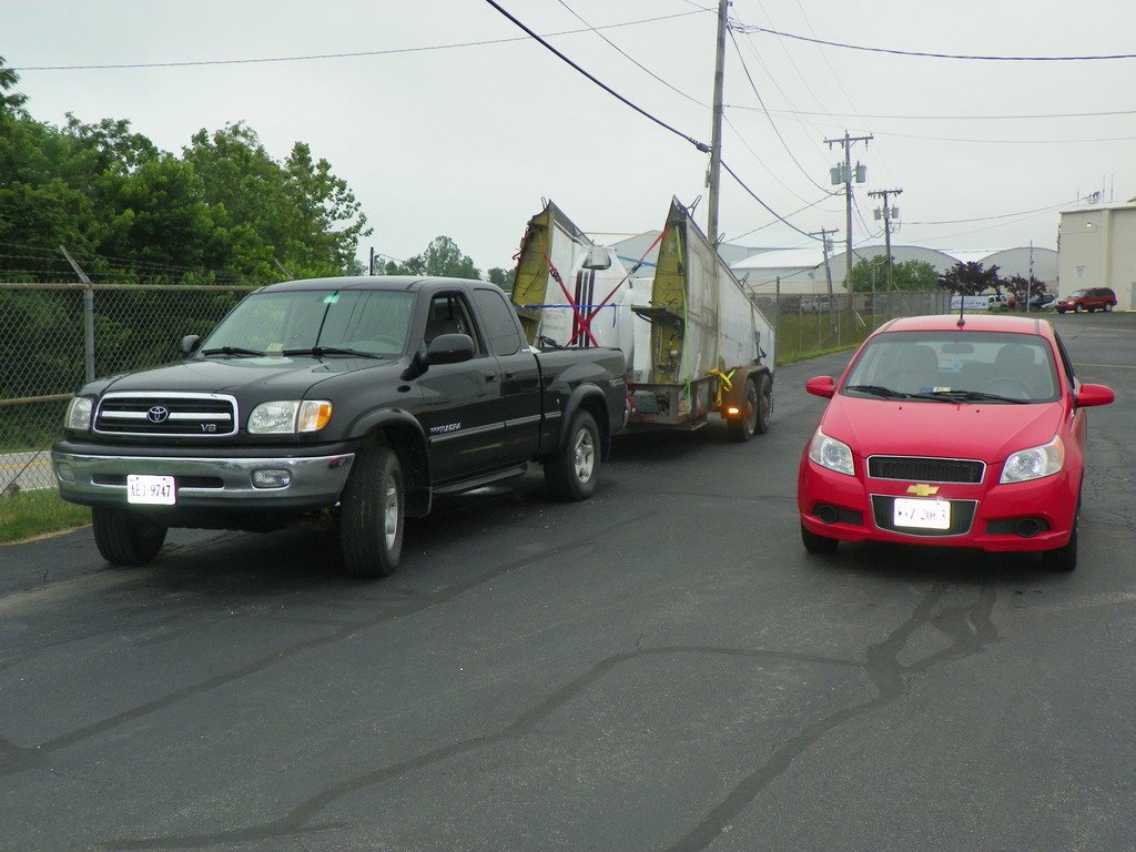

    If you have the 4.7 your capable of towing 7200lbs. So highlander (4000ish lbs) plus weight of U-Haul car trailer (2,200 lbs). You'll be close but should be ok.
    I was pleasantly surprised how well my 2000 Tundra towed through the Appalachian mountains in West Virginia on I64 years ago. I admittedly dont know what my trailer weight was but it was fully loaded 18' trailer.

    Here we are.

    If a 2nd Gen can tow a shuttle, 1st Gen can tow a High :)

    Agreed, it will help a lot.
