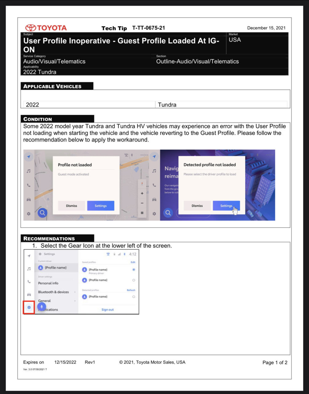

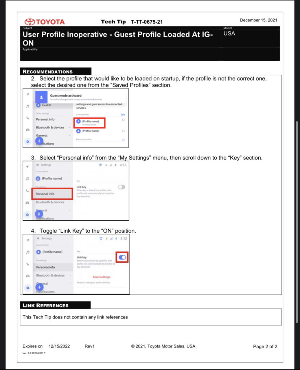

    Is your key fob linked to your profile? That usually solve people issue with the radio asking for a pin.
    First thing I did when I picked up my Tundra. Even the salesman didn’t know about it. Had to show them how to set up the radio. :rofl:
    Haven’t had issue with my radio. Turn on truck and everything connect automatically.

    How do you verify that it is linked to my profile (assume on the app)?

    I have the “keep me signed in” option on.
    As for linking the key fob.

    Awesome, I will share this with the sales guy..... LMAO
    Thanks

    I went and changed it.... works now.... thanks for the help.
