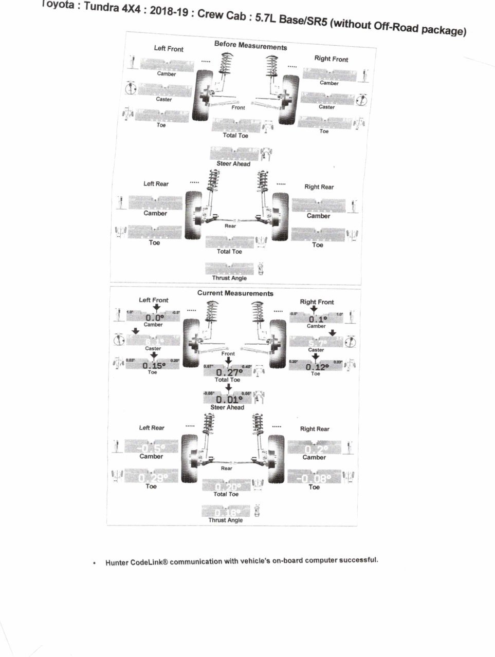

    Just installed camburgs on my 3rd gen and the instructions said the same thing as yours indicated. Just take it to a 4x4 shop that specializes in lifts and they will know what to do. But here is my sheet for reference.

    After some additional suspension research, 2-3" lift, Camburg or TC UCAs, it looks like about 6 deg positive caster, and as close to 0 deg. camber and toe as possible. Sound right?

    Way too much caster for a first gen. Try for 2.5-3 caster. Google DJ's alignment specs (pdf attached)

    Took DJ specs advice and went to the shop, was expecting a lot to change- steering was feeling more resistant and tracked ok but seemed to want to hunt around. Tech on a Hunter machine was you are almost right on as you came. He tweaked it a bit an now feels perfect as far as a test drive can tell.
