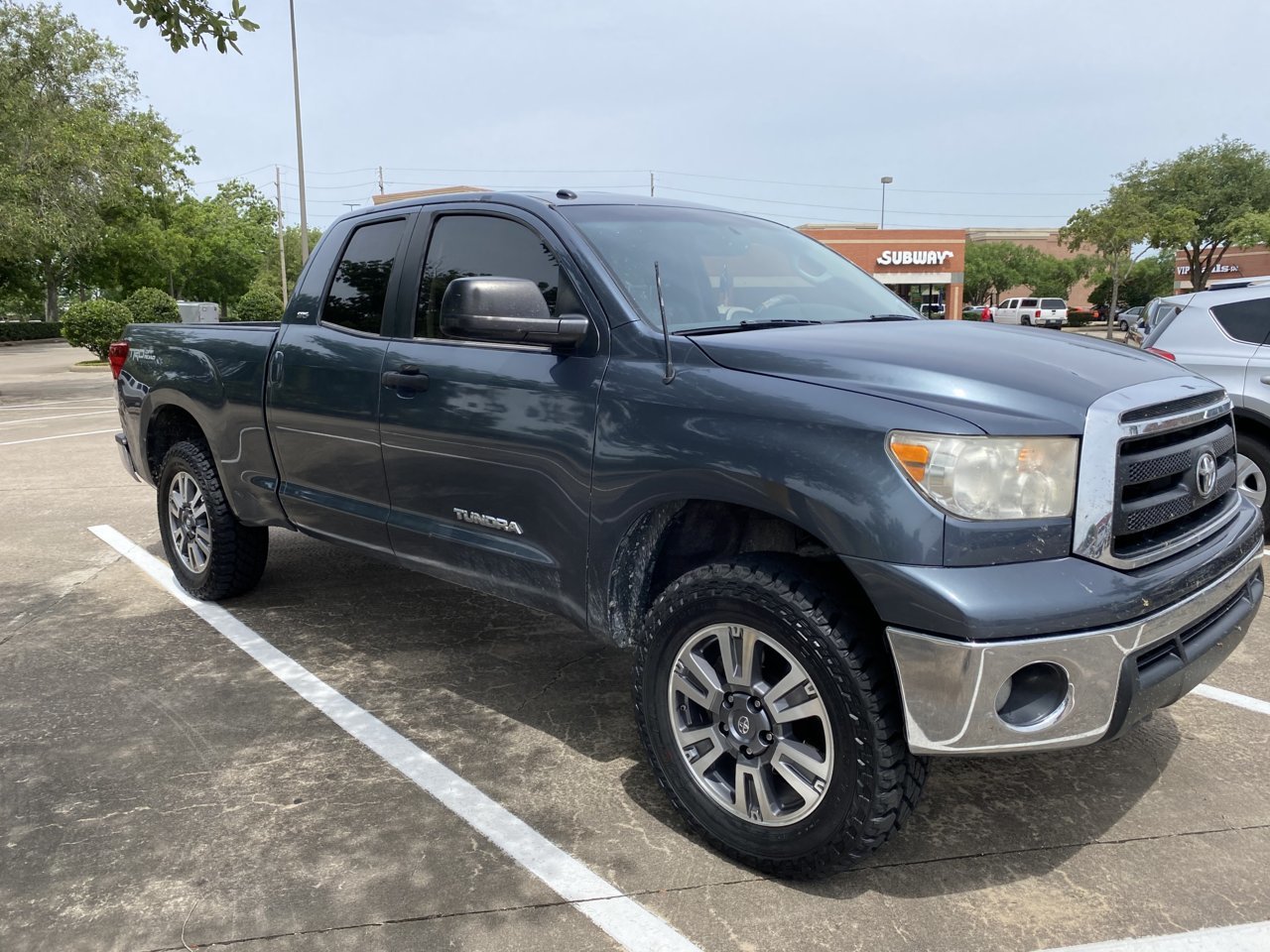

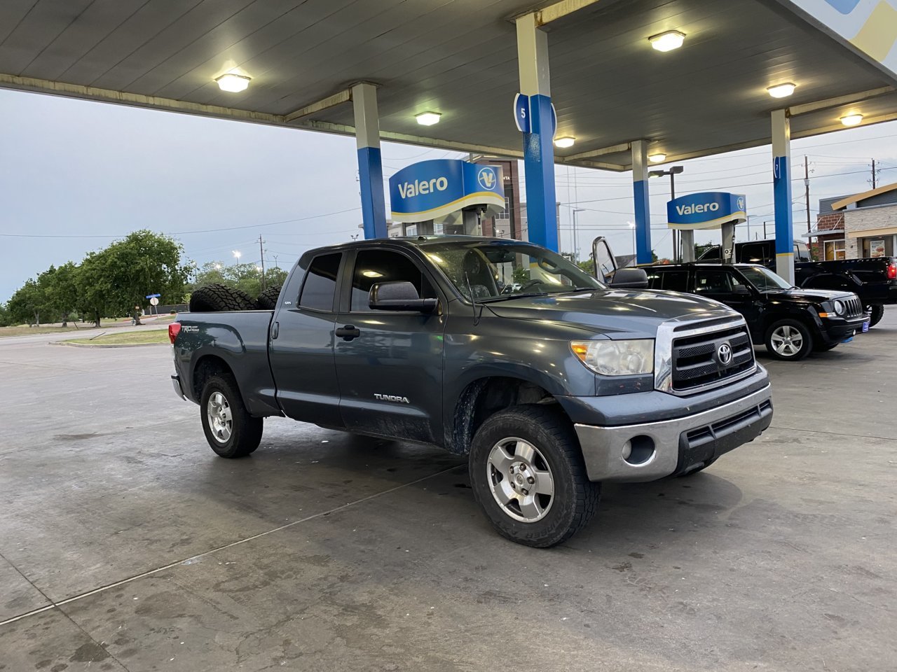

    57790EAF-FF00-488F-85AB-EA832126AB95.jpg D468975A-E4D7-48CA-8C1F-18242E215735.jpg Just got new tires and rims installed. I have a 2010 Tundra with a 2.5in front and 1in rear leveling kit. The 275/65R20s fit great.
    Before and after pics..

    That’s awesome! :thumbsup: Same 2.5” lift on my 3rd Gen, but I ended up having to trim the factory skid plate a little, and remove the front small wheel well air dams, when I put my 275/65 R20’s on, to eliminate all rubbing. Glad yours fit with no modding!!

    Well now that you say that, my skid plate may be trimmed. I’m not sure I bought it used and never really checked

    If the skid plate comes out into the wheel well further than your sway bar, you may need to, for you might be slightly rubbing the skid plate. Super easy though, just remove the skid plate, trim enough back with some metal snips so it doesn’t stick out further than the sway bar, spray the new bare cut edge with some black Rustoleum, and reinstall skid plate.
