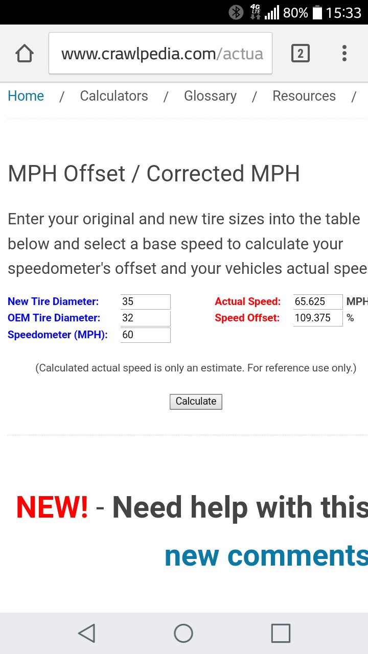

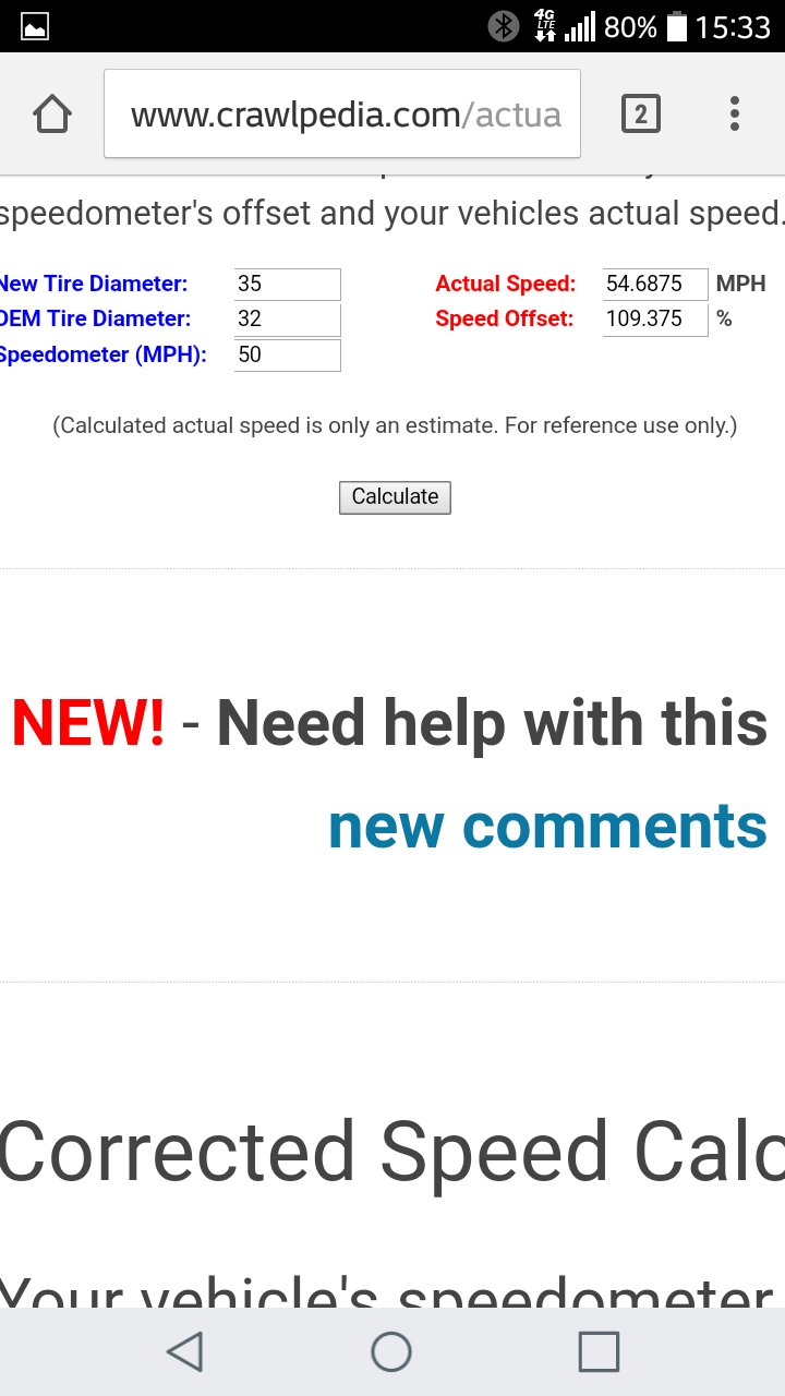

    32s to 35s gives you just over 9% difference.
    At 50 your just under 55. At 60 just over 65.
