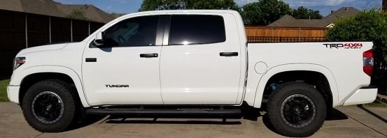

    For what it's worth I just put Fuel Anza +20 rims with Goodyear Duratrac LT275/70 R18's on a stock 2019 4x4 TRD Sport. Tires are 33.4" diameter.
    They rubbed the front mud flap in reverse at full turn. I took all mud flaps off, just because. I'm happy with the look. Not going to level so I don't mess up the TSS.

    how it looks
  8. Apr 27, 2020 at 12:59 PM
    Asimov2025
    Asimov2025 Not Sure
    Feb 19, 2020
    #42850
    914
    Trent Woods, NC
    2019 TRD 4x4 Sport
    Non-stop mods
    ^^^Looks great!

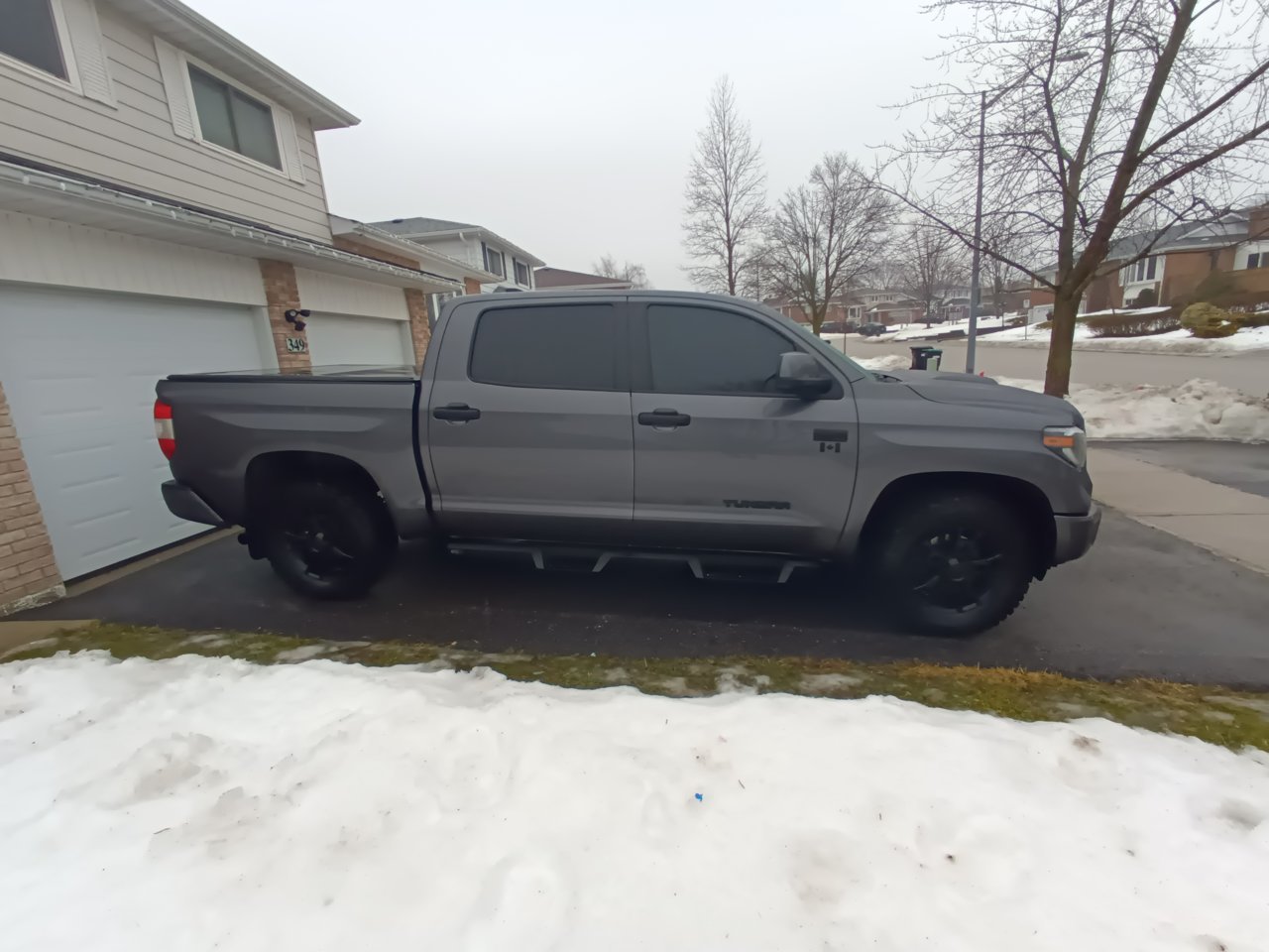

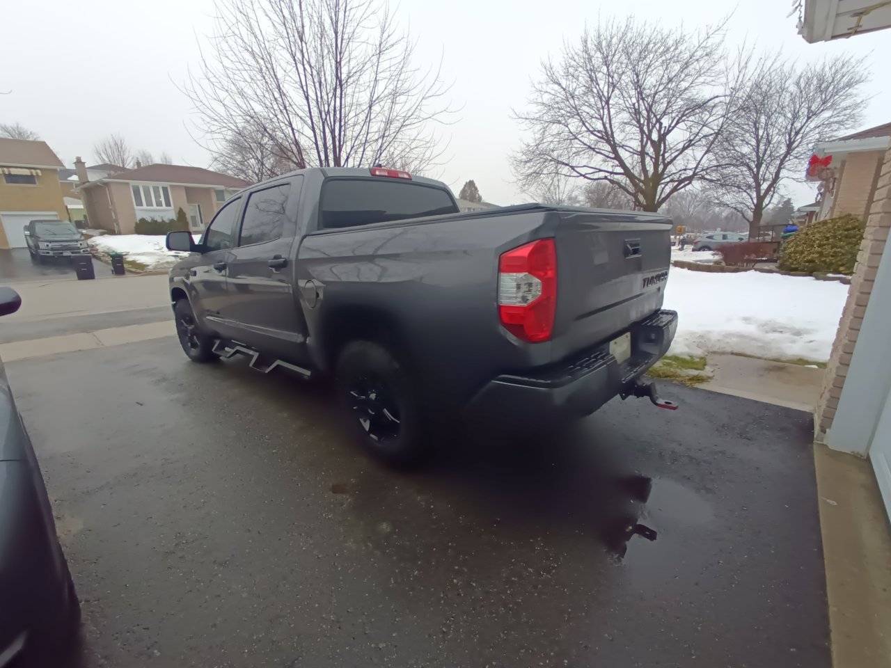

  18. Mar 7, 2022 at 1:06 PM
    Walkem
    Walkem [OP] New Member
    Apr 5, 2020
    #44677
    86
    Canada
    2020 TRD Sport Premium CMax
    Sorry for the poor quality. It was raining.
    Budge likes this.

    Walkem
    Thanks for the candid reply, that is the kind of feedback I was looking for. 2.0 L/100K is to0 much for me to loose and therefore will need to rethink my plan and look for something lighter (P rated???) but still rugged looking. Truthfully, I am 95% on paved roads and only wanted an AT tire because I like the look. Having said that I will only plan on keeping my current Tundra for a few years as I wait to ensure Toyota's QDR remains with the redesign.
    What tires will you put on your new 4Runner?
    I purchased the Replika R226 (love the black finish as well) for my winters and are currently running Nokian Hakka winter tires. I only put 1000km on my 20" sport rims and tires as I got my Tundra in November.
    Thanks for the pictures from the side of your truck it looks great.
