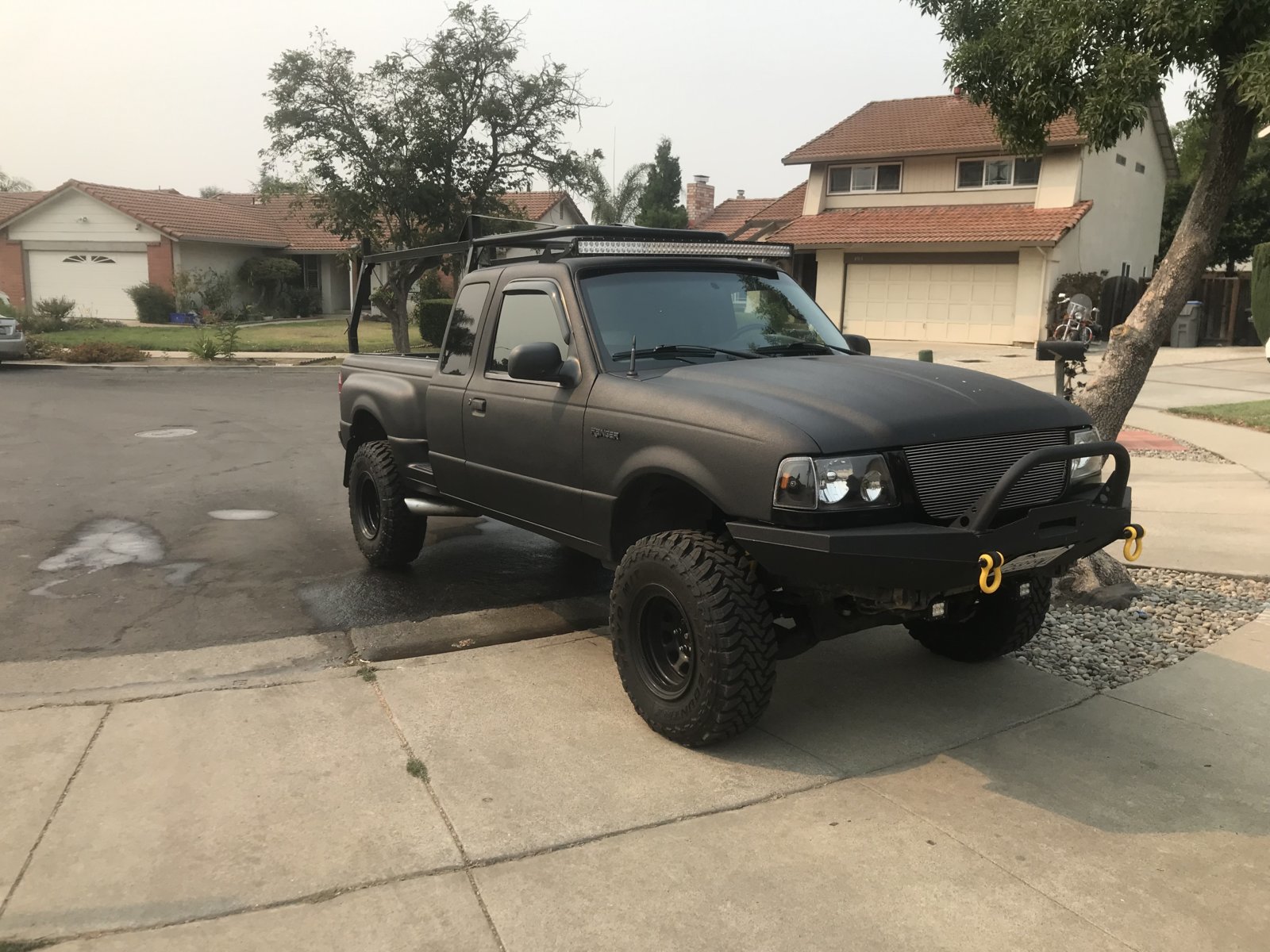

    I used to have an ‘03 ranger xlt that I rhino lined the whole truck. Came out nice and was definitely a neck breaker lol would I recommend painting even just a camper shell let alone a whole truck? Not really, unless you’re looking to really thrash it hauling material or off roading.
