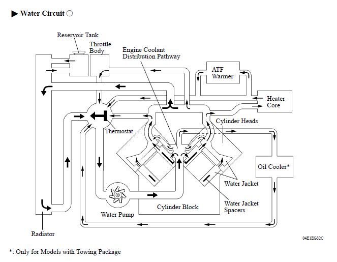

    Due to someone inquiring about a heater core by pass my curiousity was raised a bit and I began to look around a bit under the hood. Best I can tell the engine coolant flows through the heater core prior to the "puck" which leads me to believe that the engineers actually decided that the heater core could be somewhat of a transmission cooler due to some heat exchange taking place in the cab either from heating or cooling the cab. Then said slightly cooler than engine temp coolant would flow to the "puck" and cool the transmission oil before returning to the water pump. Is it worth a damn? IMO, no! So, I do have an auxillary cooler. However, I can see some attempt made by the engineering team to reduce the transmission temps. Yes, the coolant going from heater core to the "puck" would also aid in transmission warm up when cold, hence "cooler/warmer" terminology.

    I would wager that the reason for the heater core being first to get the hot water is more so the interior of the vehicle will warm faster when outside temps are cold. Passenger comfort before tranny concerns.

    Of course, but still stands to reason for the then cooled coolant to flow to the puck next to aid in cooling the trans.

    The coolant that goes to the puck comes off the heater core outlet. Measuring a few different times the coolant is about 205F. It was easily the hottest part of the coolant stream. The bottom of the radiator was 130F.
    I experimented with this. I bought a heater core from a 1980's vintage suburban. It was large and had similar inlet and outlet hose sizes. I put the heater core downstream of the heater core, in series with puck.
    I put the heater core zip tied to front of truck (temporary). I ran it up and down freeway at 78 mph with some full throttle runs. At best it knocked down about 5-6 degrees.
    What I learned is that despite the ease of putting a cooler on 'coolant' side it has to be the size of a mini radiator.
    To get additional cooling from the puck, by decreasing coolant temp, the coolant temp has to get much much cooler (like say the 130F in bottom of radiator).
    The Tundra puck is basically the same thing as an 'in tank' transmission cooler but inverted if you will.
    Given the small surface area in the puck, you'd really have to cool off the coolant really really far to have a major impact on transmission fluid temps. It'd have to be at least 130 F. This drives up the size of the cooler.
    Mishimoto and other such companies make all manner of radiators and coolers (heat exchangers). But a large one will run in the $400-600 range and still require some fabrication for installation.
